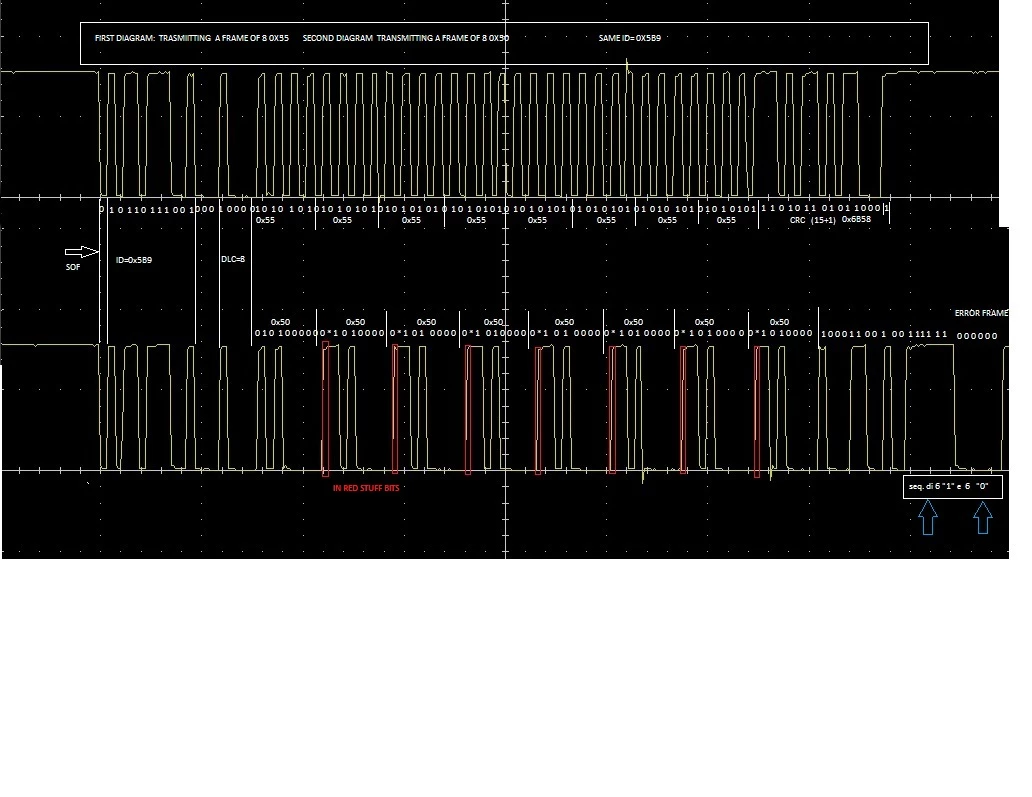

I'm using a ST32F466 trying to connect a personal board to a PEAK analizer.
The code is generated in part by MS32Cube, and in part by me on TrueStudio 9.2 using HAL libraries.
After setting the CAN1, (HAL_CAN_MspInit()), I have configured the CANHeader (configCANHeader()), the filter (configCANFilter())
I start the CAN (HAL_CAN_Start()), and activate IRQ on
-- Transmission complete,
-- SCE
-- Reception
Every second I try to send a frame using HAL_CAN_AddTxMessage().
Everithing seem correct if I send frames with NO SUFF BITS ( for example 8 times 0x55).
If I try to send frames with many STUFF BITS (for example 8 times 0x50) after first attempt (correct), an ERROR FRAME IS GENERATED and in the ESR register I find LEC=3
The tracks I have registered are on the micro, before the level transceiver.
Some idea?

If I try to connect CAN1 to CAN2 in the same board ( is not a real loopback) , using two different transceiver, everirhing seems go right....
In this case the system use the same clock source.
Now I try a real loopback, thank you..

The transceiver is mounted on the card so I don't think there is a problem. As turboscrew suggested, I tried loopback and the reception is correct. So I think I have a problem with clock frequency or timing (SJW, BS1, BS2) although, for the latter, I've tried many different solutions.
I still don't understand, if I try to transmit 8 tumes 0x50, why the first frame is received correctly. In the event of an error the TEC register reports 8 errors , therefore an error for each byte. Note: the micro is a 446 ; nervous ....
varani luciano
July 2, 2019
Solution.
Changing quartz .
