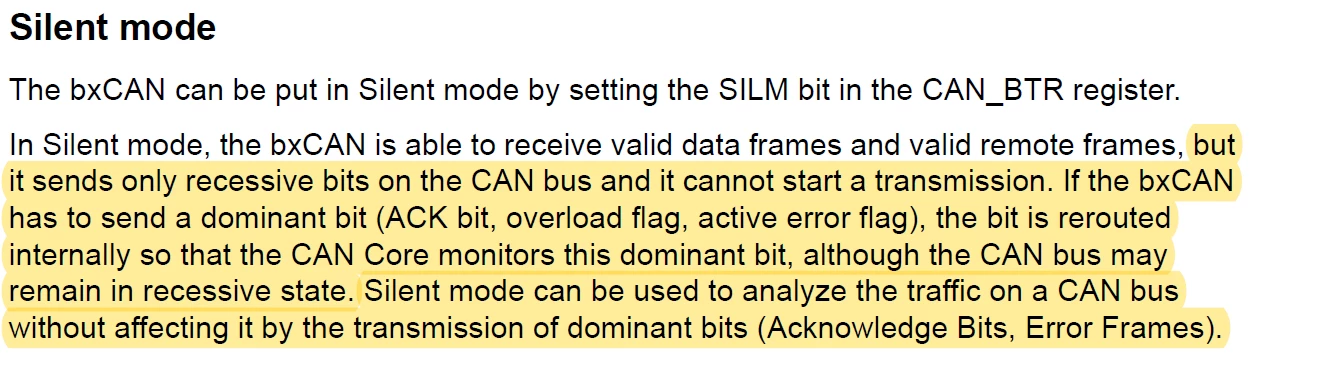

At least one of the nodes B or C will acknowledge the reception. It can be B or C or both. This is valid where node B and C are in normal mode. In silent mode, the behavior is different and B and C still receive CAN frames but they are sending recessive bits on the bus and the ACK bit is sent internally in their respective CAN cell.
From RM:
An OBDxx should follow the CAN spec but I don't know if it's in Normal or in silent mode.
