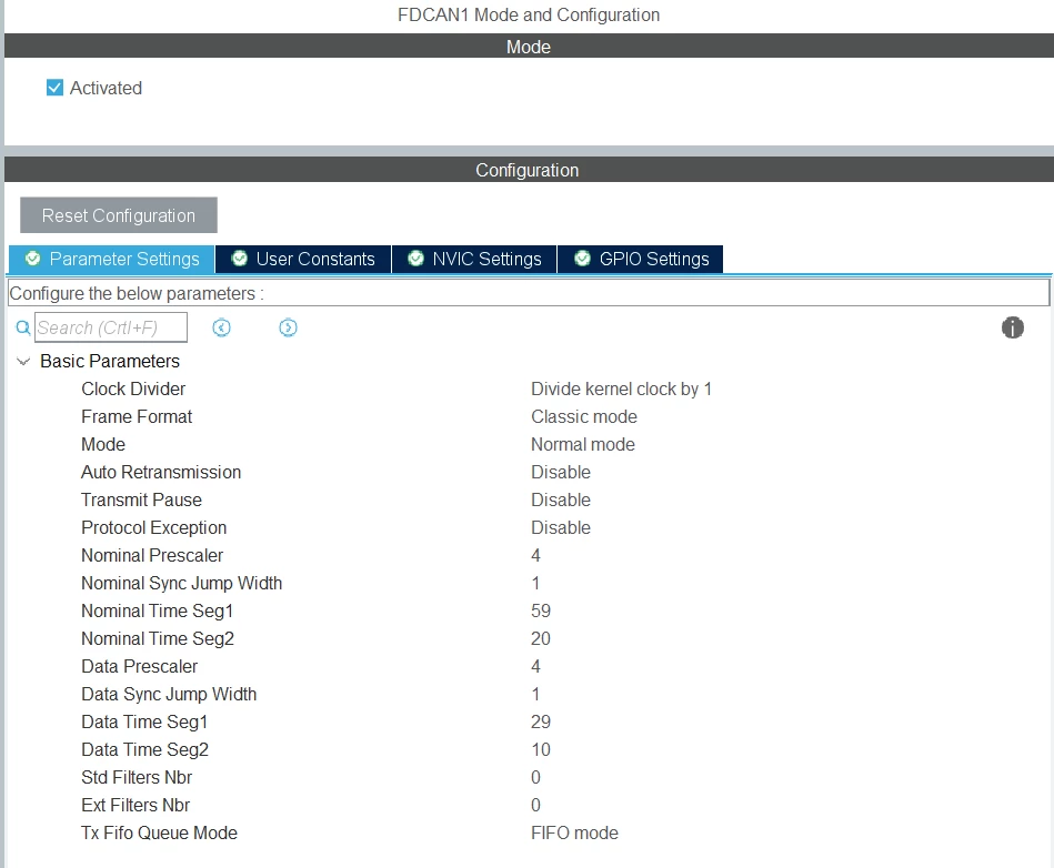

CAN Bus 2.0 and CAN bus FD
We have developed our control system around CAN bus 2.0, but we are trying to move up to the H7, and it only has CAN FD. The question is, can CAN bus FD be configured for operating like CAN bus 2.0?
mƎALLEm
mƎALLEmBest answer
November 16, 2021
Yes, you can configure H7 CANFD peripheral to operate in CAN classic mode.
Please refer to the example provided in STM32CubeH7 under the path: Projects\STM32H743I-EVAL\Examples\FDCAN\FDCAN_Classic_Frame_Networking

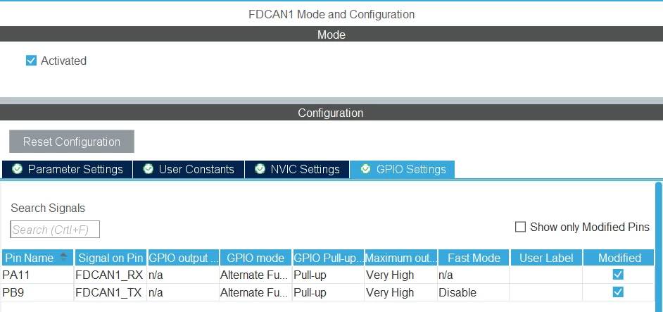

IAgui
IAguiAuthor
December 13, 2021
Hello seppeltonics_v and all,
I got this working. I had to figure out how the bit alignment of the extended ID CAN 2.0 with their FDCAN_RxHeaderTypeDef as we use the protocol slightly different from typical.
seppeltronics_v
December 13, 2021
this is what I have used, at least it spit out a CAN-Frame. Please also check the IO-Setting, you may have to go to the GPIO-Setting, the IO-Pin-Speed may be an issue as well, I set them to "very high" and "pullup", I would also recommend "Fast Mode", if you got EMI issues, you can play with it later.
Best Regards, Seppeltronics
IAgui
IAguiAuthor
December 13, 2021
Yes, thank you it's working. I successfully configured CANFD to work as CAN 2.0.
