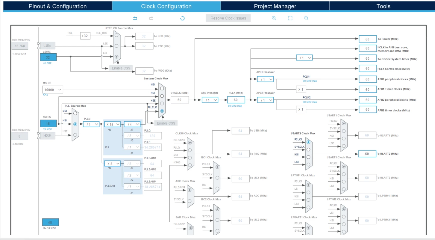

September 25, 2024
Hi Imen,
I’m working with the Nucleo STM32L433 and don’t have an external clock available. Do I need to solder on an external clock, or can I use the internal HSI? I’ve configured the HSI to run at 60 MHz and set the CAN baud rate to 125 Kbps.
