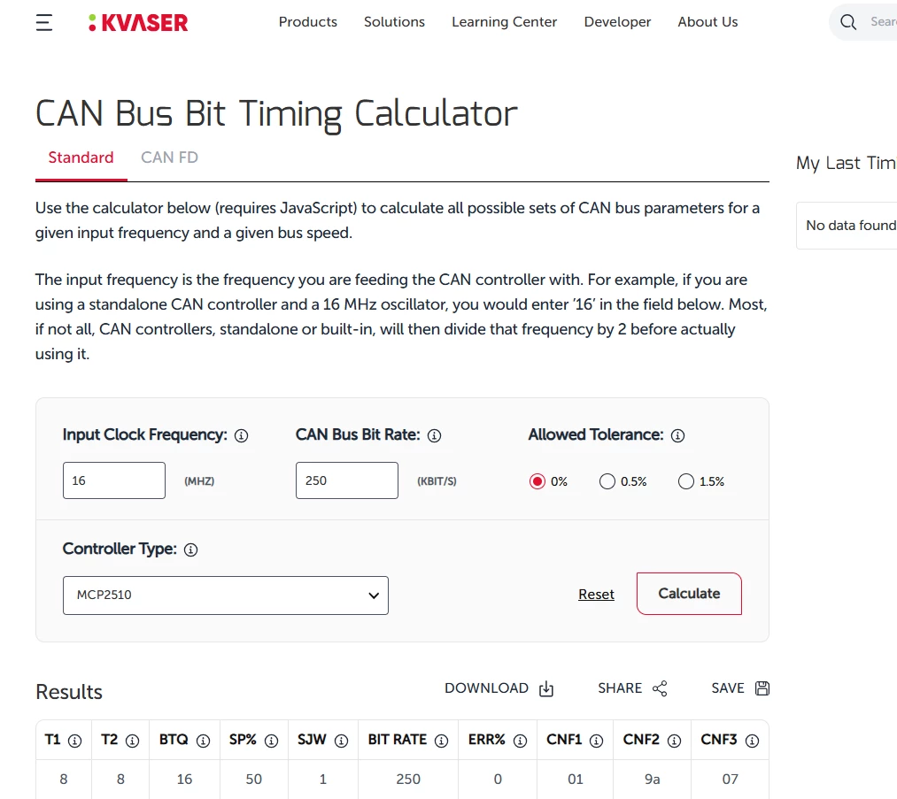

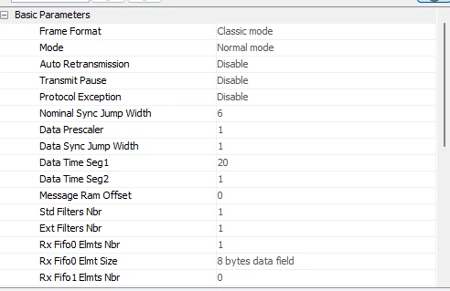

use this website for can bit timing calculations , they also have support for CAN FD, just provide your clock , which is being fed to the FDCAN peripheral (You can look for it in the clock configuration in the project's ioc file)
and the required bitrate as well as the tolerance.
below is an example of CANFD bit-timings for a NUCLEO-755zi-Q board
I am using CANFD (Classic mode)
Bitrate required was 250kbits adn the clock frequency is 10Mhz
NOTE: These bit timings are not MCU specific, the dependencies are Clock source to FDCAN / CAN and the required bit rate , also the Bitrate can be limited depending upon the CAN transceiver used.
