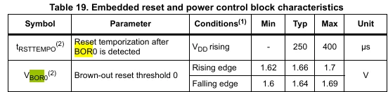

Based on the STM32G4 reference manual and datasheet, VBAT operates in the range from 1.55 V to 3.6 V. However, the lowest brownout reset (BOR) level is 1.71 V.
So, as long as the voltage remains above the BOR0 threshold, which is 1.71 V, the (RTC) and backup registers continue to function correctly.

> Is it possible for the VBAT voltage to drop to a level where the RTC stops running, but the backup registers still retain their contents?
Yes.
The datasheet values tell you a VBAT voltage value, above which *both* will function. There's no *guarantee* what happens *below* that value; but in CMOS, typically, memory content is retained to lower voltages than the voltages needed to flip the flops (and/or run an oscillator).
> I need a reliable way to detect that the RTC has stopped while the backup registers remain intact.
You won't have any, built-in into STM32's Backup Domain. Mind, anything precise requires power. (Also, note the "backup domain brownout" erratum.).
You have to design your system so, that it maintains enough power at VBAT for whatever time you require.
Alternatives to this may be schemes not utilizing the backup domain, but using some of the lower power modes, monitoring any battery/backup power utilized using e.g. PVD and waking up briefly to destroy backup registers/reset RTC. This will be at a cost of higher power consumption, though.
Another alternative may be to run from VBAT but wake up for destroy through alarm after the maximum RTC retention design time was reached.
If you plan running VBAT from supercap or similar, charged through a switch (e.g. using the built-in charging mechanism), you can try to measure its voltage after wakeup and decide whether that was sufficient for the previous RTC run.
