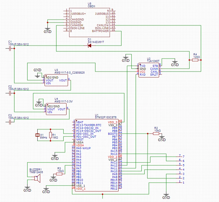

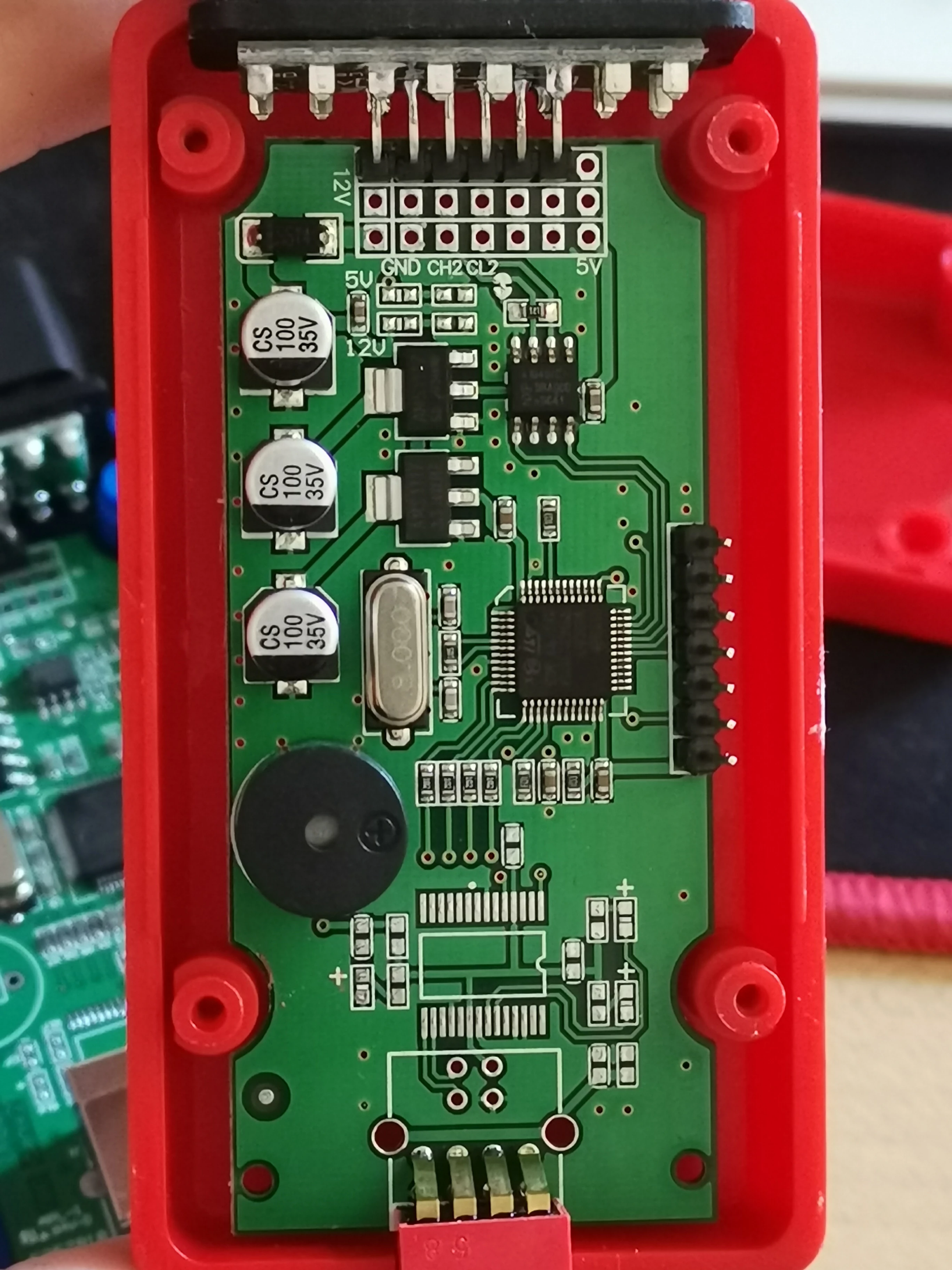

I've been trying to reprogram some modules made to transmit some CAN data frames to a car when plugged in the OBD socket. Basically the MCU is programmed to send some frames and I'd like to replace these frames with others ones.
Here is a picture of the device as well as a schematic I made :
0693W00000Lwpq8QAB.jpg0693W00000LwpqrQAB.pngThe MCU is a STM32F103C8T6 and the CAN transceiver shows the writing "NXP A1040/C DBA000 D64.1" on it. When I type that in Google it returns the TJA1040 high speed CAN transceiver : https://www.nxp.com/docs/en/data-sheet/TJA1040.pdf.

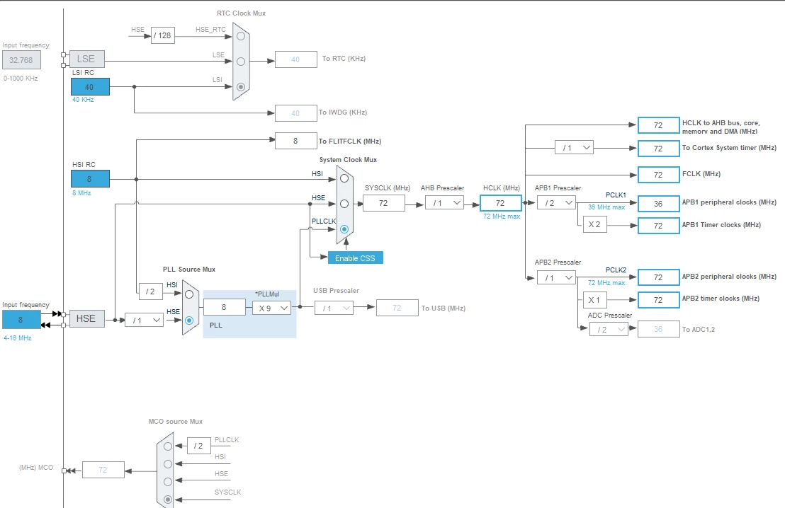

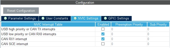

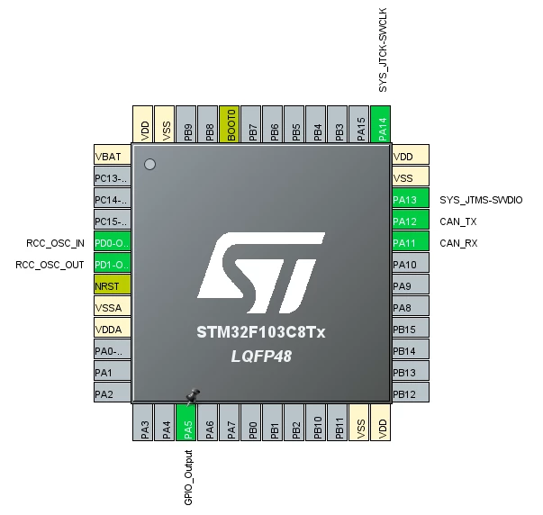

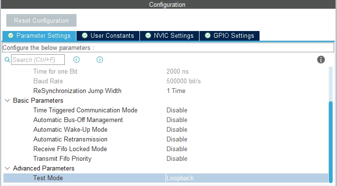

So I did a bit of research and started my project. Here is the configuration I used in MX :
0693W00000LwpwGQAR.png0693W00000LwpwLQAR.png0693W00000LwpwpQAB.png0693W00000LwpwuQAB.png
I first started by trying to use the buzzer to test the basics and it works. Then my next step was to use the CAN loopback mode to try and see if I could send/receive messages. This is where I struggle.
I joined the whole code below. It compiles and runs (I use a ST link to debug). It just never gets into the interrupt function that is supposed to activate the buzzer. Please note that the transceiver is correclty powered with 5V from the ST link during my test (I checked with a multimeter). I really have no idea what's my issue, any help would be greatly appreciated. Thanks in advance !

Best answer by mƎALLEm
Please decrease the prescaler as much as possible and increase BS1 and BS2 in order to match your bitrate of 500kb/s
I propose for example:
Prescaler = 4
Bit Segment 1 = 11 Times
Bit Segment 2 = 6 Times
PS: if you disable the filter you cannot receive any frame; the CAN cell will acknowledge the received frame but the data of the frame doesn't go to your FIFO.

You didn't mention what you're using for the second node when testing your code. CAN requires a minimum of two nodes, connected with twisted-pair wire, and a termination resistor at each end. Both ends have to use the same data rate and bit timing.
You'll need to enable the SCE interrupt to trap errors. At a guess you have bus errors, which is why your RX interrupts don't trigger. Too many bus errors and the transceiver will be disconnected from the bus, without sending or receiving any messages. Check the status registers in the SCE interrupt to determine what your error is.

Thanks a lot for your answer. I don't have another node (just a resistor). I thought that with the loopback mode it wasn't necessary. I was referring to this video : https://www.youtube.com/watch?v=JfWlIY0zAIc&t=0s where the author also uses the loopback mode with no other node. Is that a mistake ?
Since there is no other node on the bus I guess there should be no error right ? I'm very new to all of this (this is my first electronics project) so I'm sorry if it takes a lot of explanation to make me understand something.

When you are using CAN in loopback mode, the transceiver does not have effects and you can remove it if you want. The purpose of this mode is to test CAN communication without any external HW (transceivers, termination resistors etc ..)
Prescaler = 4
