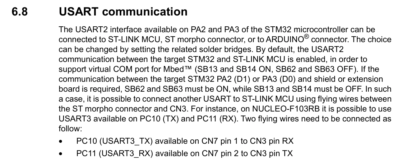

it cannot show anything in tera term

> STM32F446RE
So probably the NUCLEO-F446RE board?
What pins are you using? Are they connected to what is sending data to tera term?
YakryAuthorBest answer
February 26, 2025
clock is the problem
and thanks for your reply
