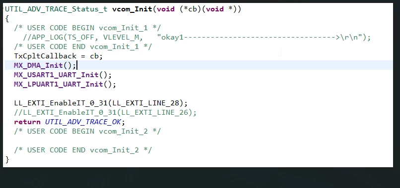

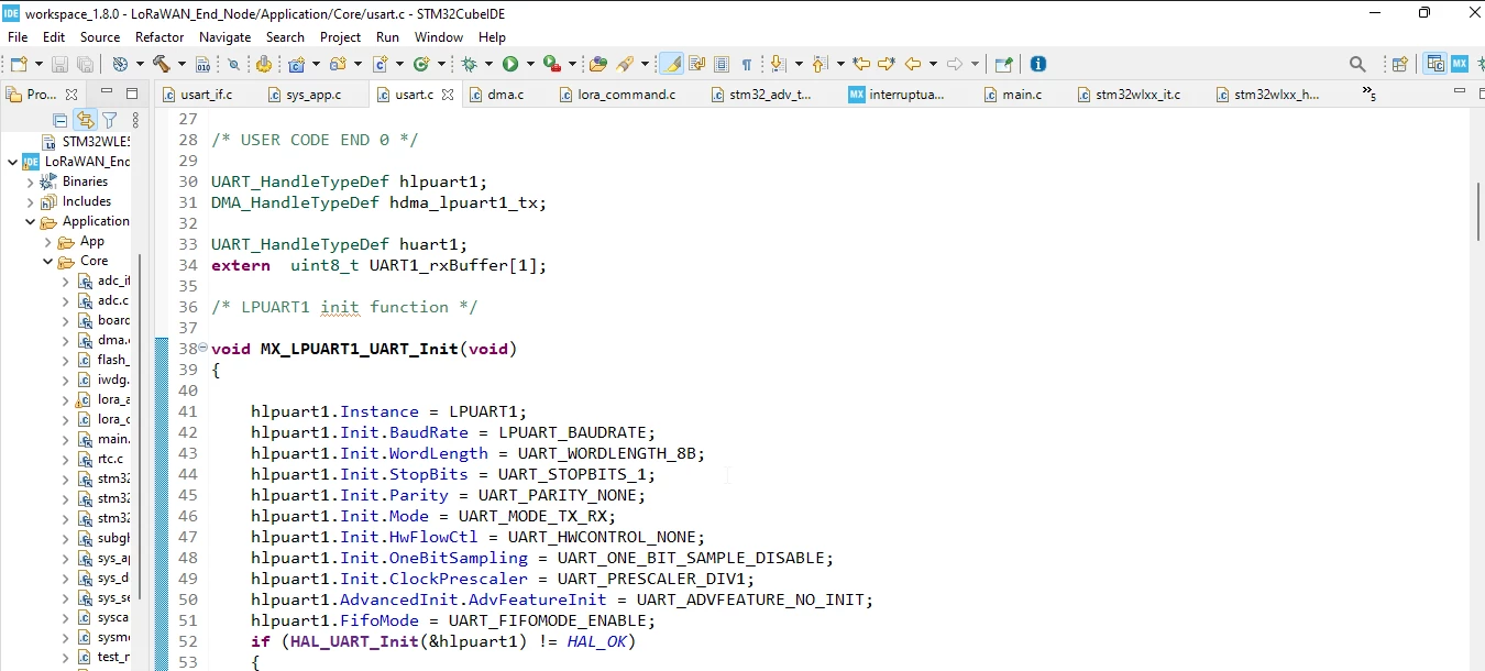

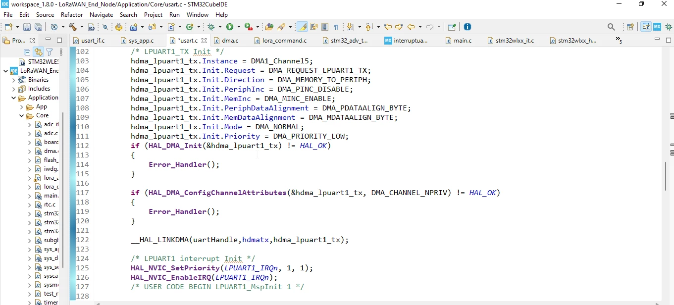

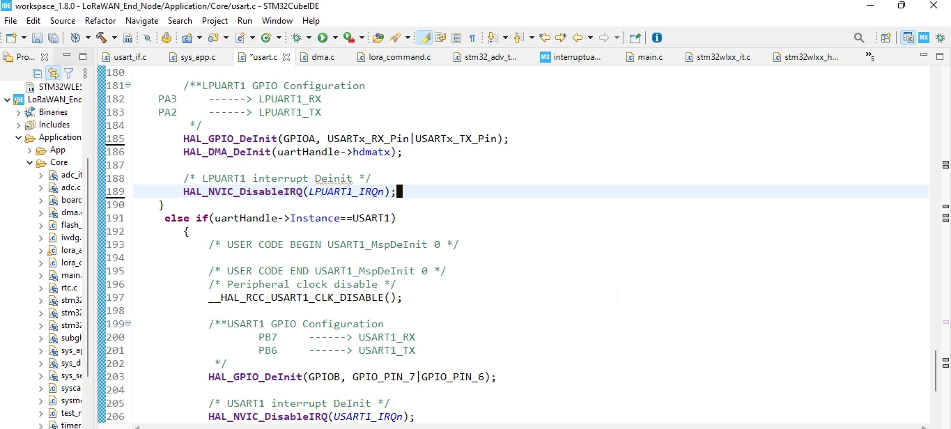

Currently I am working in Uart interrupt in along with LoRaWAN in RAK3172 module(STM32WLE5JC MCU).
I had worked with 2 UART interrupt without LoRa its working fine which was generated in STM32CubeIDE.
while trying to integrate one Uart interrupt with another LPUART interrupt which was used for AT commands configuration in LoRa its not working.
Below I have attached the Configuration Screenshot step by step
Kindly support for rectify this issue.
Thank you!
SS.28
SS.28Author
December 6, 2022

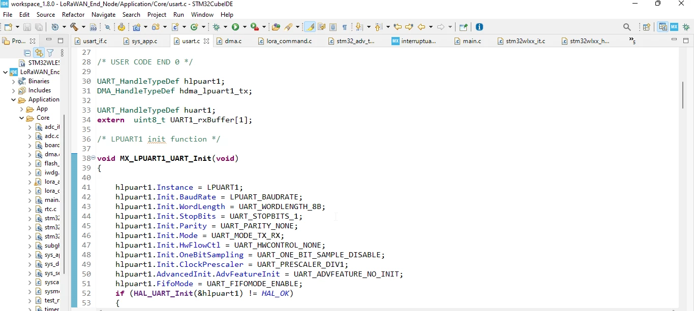

Step 1: LPUART init function0693W00000WKN3uQAH.png

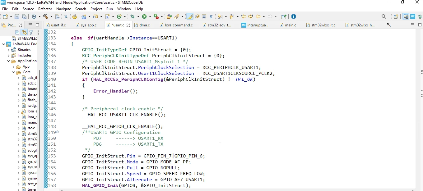

Step 2 : UART1 init function

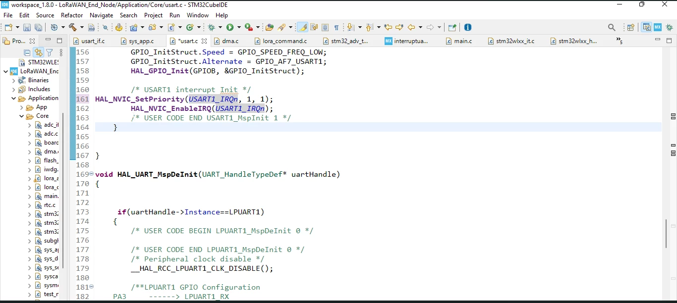

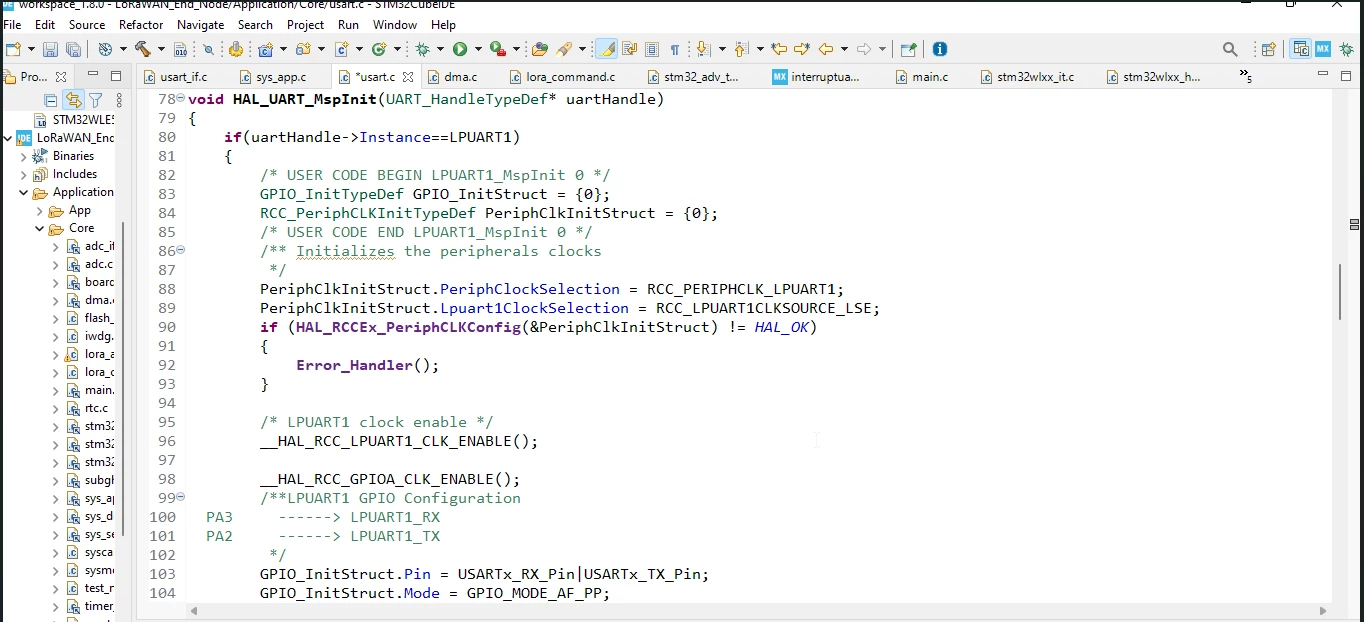

Step 3: Uart Msp init

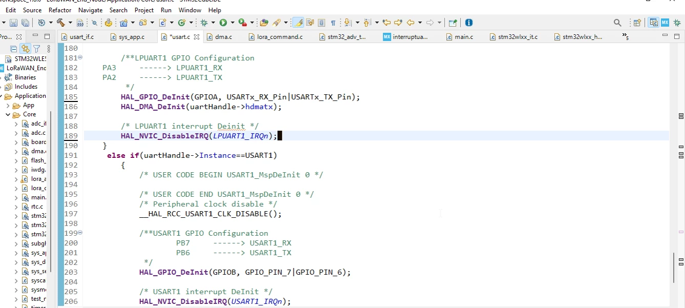

STEP 4 : UART MSP Deinit

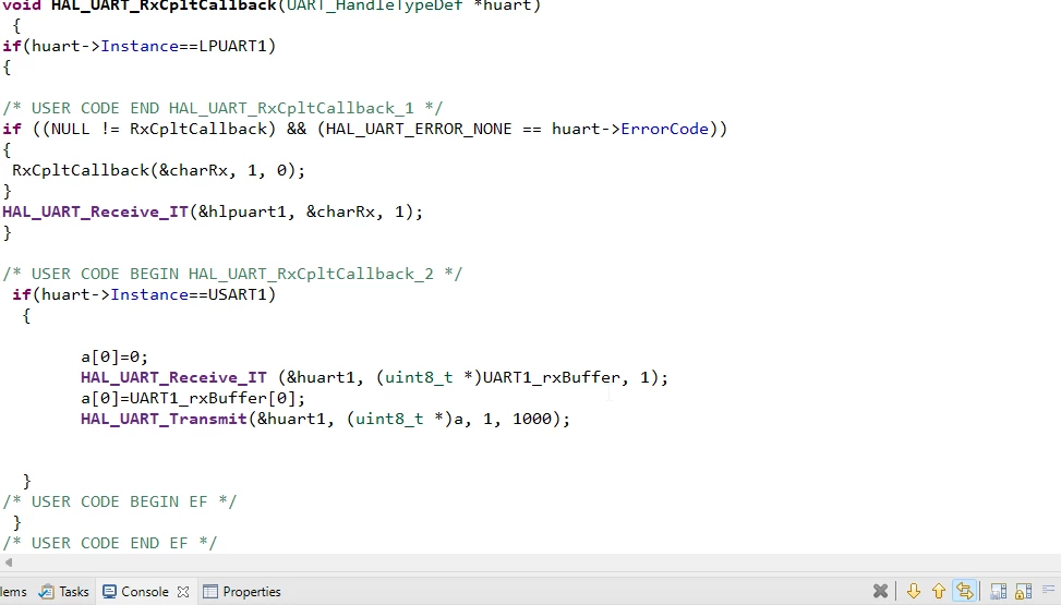

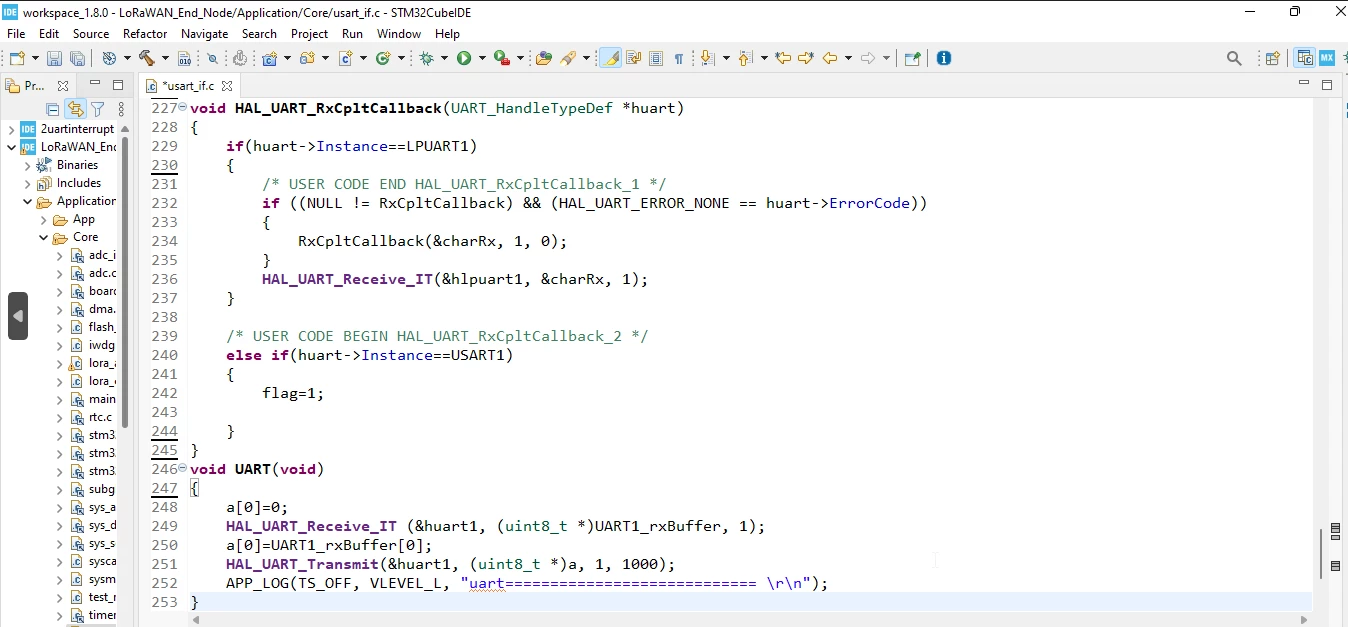

Step 5: Calling UART
Step 6:Uart Callback function
 uint8_t UART1_rxBuffer[1]={0};
 uint8_t a[1]={0x00};
Tesla DeLorean
Guru
December 6, 2022
Don't put Blocking functions in callbacks, they are done under interrupt context, and will stop other interrupts of same/low priority from executing.
Do whatever work you need to do and leave, quickly.

I have changed the NVIC priority in LPUART1 (PreemptPriority, sub Priority-->(1,0)) and UART1 (PreemptPriority, sub Priority-->(2,1)) still now I have facing same issue
Kindly guide me to rectify this issue

KiptonM
Senior III
December 8, 2022
The only thing a uart interrupt should do is move the data from the UART to memory (in the case of a RX interrupt) or move data from memory to the UART in the case of TX interrupt. You can add 1 or subtract 1 from a counter and set a flag, but beyond that nothing else should be in the interrupt. "
Do not process the data you received. That should be done in the main program.
Do not have anything in the interrupt that needs to wait for something else to happen. That is what they mean by no blocking functions.
If you go in and out of interrupts as fast as possible you are doing it right. If you are doing more, then you are doing it wrong.
S.Ma
Principal
December 10, 2022
Was the default lora sw define an uart interrupt handler and yours is not used? Test by trying to put breakpoint in yours.
Interrupts as said before should be very brief as they replace hw.... header byte screening, push byte in a sw fifo to queue them up for other slower non interrupt sw to manage.
You should put both uart interrupt same prio.
Put breakpoint in each isr to check you *** there. Even stop the code, check the hw registers values to make sure all is well configured, manually adjust amd let the code continue untill you get the interrupt breakpoint. You are in code debug mode, dig...

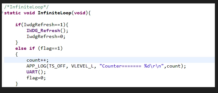

SS.28
SS.28Author

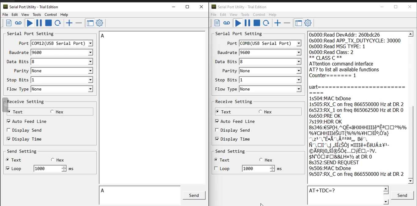

December 10, 2022
@KiptonM​ @S.Ma​
I have checked below points
--> I put a flag in RX complete call back function and I check the flag in while loop and also I set increment count in while loop.
Result:
After reset the device that time only UART1 interrupt is triggered. Below I have attached the screenshot
And also I have set the same priority in LPUART1 and UART1 its not working
set flag in RX complete call back function:
Serial Monitor:
