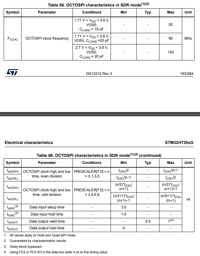

Hi @Saif​ ,
Thank you for sharing your request.
In fact the QUADSPI is an another way to configure your OCTOSPI peripheral.
So all the specifications applying to the OCTOSPI are true in case of QUADSPI configuration.
0693W00000Nsc0OQAR.pngPlease find in attached the datasheet and refer to the section 6.3.20 "Octo-SPI Interface characteristics" for more details.
Best Regards,
A.MVE
Saif
SaifAuthor
June 23, 2022
Hi @Aime​
Thanks for your reply.
I didn't properly explain what I was asking for. I put my question differently.
I am talking about the bandwidth of the external RAM.
How do I calculate the bandwidth of a QUADSPI external SDRAM?
Best Regards,
Saif.
