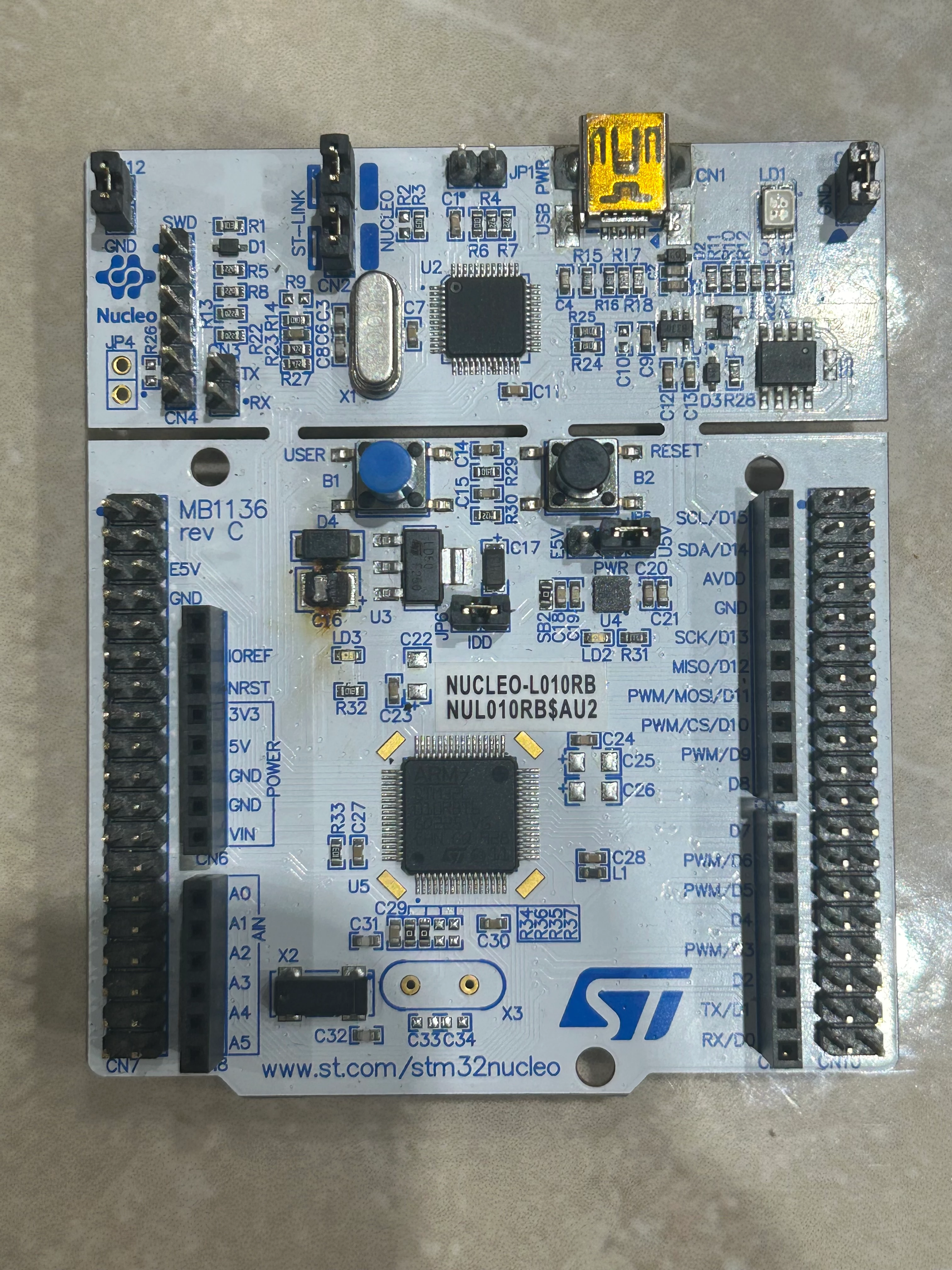

While connecting the battery, the ground was inverted with the VCC and vice versa. As a result, this capacitor burned out. I need to know the function of this part and if I can continue to work normally after what happened.

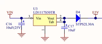

see circuit:
C16 and probably U3 needs repacement. (maybe C17 also.)
Check if connecting USB : st-link and cpu L010 still working (they should).

Bulk capacitance on the input side of the regulator.
It's destroyed itself, so likely not part of the active circuit at this point. Check if it is open-circuit now with a meter.
I'd expect the board might continue to function, regulation will be less good.
Do you have the skill/equipment to replace?
