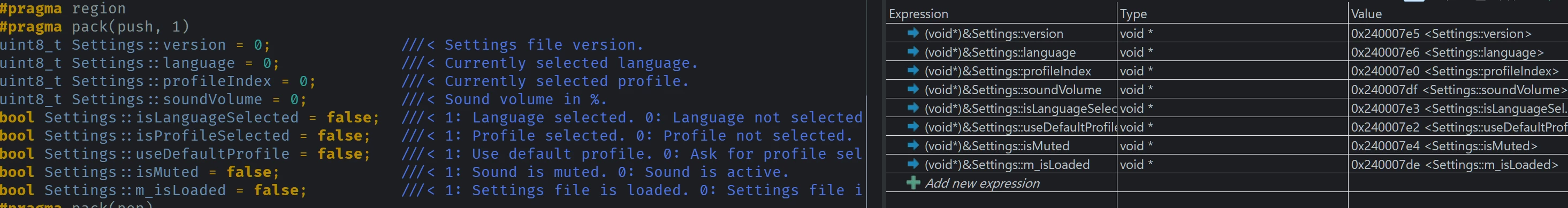

    Unfortunately, that's not the problem. Packed attribute (and `#pragma pack(push, 1) / #pragma pack(pop)`) works regardless of optimization options. The struct data are packed, however, the ORDER of variables is changed!
    Here are my static members in order of definition in class header:
    0693W00000Y8wZVQAZ.pngNotice the weird address assignments! Without optimization the order of the static members is as defined in the header.
    The obvious fix for it is to create a separate structure for the data and use that structure for dumping data to a file, but that's adding probably unnecessary complexity to a simple piece of code.

    It was the problem old as dinosaurs ;) I had a piece of code working as a tool (thus static) and it had some stored data (configuration). In a hurry, I mixed it in a way they never should be mixed. The solution was just to use a packed struct with the data. I also made a little test to see what happens with the memory layout.
    > Compiler folks do not dare to do that, otherwise angry users would come to them with fire and pitchforks.
    Exactly! So packed (1) is packed (1), always. Thanks for reminding about compiler warnings when packed attribute is misplaced. Pragma pack doesn't seem to emit warnings. However, unlike __attribute__((packed)), it's valid in MSVC, so I can use it in code that is compiled in VS.
    Also, memcpy() emits a warning. For this reason exactly.

    GCC can/will change the order of variables in memory depending on optimization levels. I hit this issue with the AVR GCC when allocating variables in the EEPROM space. Data written when compiled with "-Og" were not readable with code compiled with code compiled with "-Os". The solution, as you mention above, was to declare a structure that filled the entire EEPROM space and put the variables in the structure. The order inside the structure is guaranteed by the C/C++ spec.
    I haven't seen this issue with the STM32, but none of my STM32 code attempts to do what you are doing. I suspect you are seeing that same issue, with the three static members of X being placed in memory in a different order with different optimizations.

    Line 13 before fixing - not ;) It's a bad example. The problem with it, beside it illustrates a bad idea - is (after fixed `uint16_t` to `uint32_t`) it compiles, runs and `ok` is `true`. It happens because the compiler has no reason to reorder the static members in memory. In my real world code reordering occurs. Static members are fine, but they are something completely different from regular struct members. When no optimization is used, they behave exactly as the class was a singleton instance. With optimization the difference becomes apparent.
