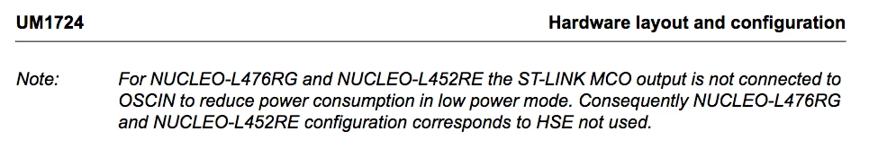

Cannot get HSE Bypass to work for L476 Nucleo board, when 446RE Nucleo and F103RB Nucleo work fine.
this stm32cubemx generated code spins in the _Error_Handler. Im thinking a bug in stm32l4xx_hal_rcc.c so far.
  RCC_OscInitStruct.OscillatorType = RCC_OSCILLATORTYPE_HSE|RCC_OSCILLATORTYPE_LSE;
  RCC_OscInitStruct.HSEState = RCC_HSE_BYPASS;
  RCC_OscInitStruct.LSEState = RCC_LSE_ON;
  RCC_OscInitStruct.PLL.PLLSource = RCC_PLLSOURCE_HSE;
  RCC_OscInitStruct.PLL.PLLM = 1;
  RCC_OscInitStruct.PLL.PLLN = 20;
  RCC_OscInitStruct.PLL.PLLP = RCC_PLLP_DIV7;
  RCC_OscInitStruct.PLL.PLLQ = RCC_PLLQ_DIV2;
  RCC_OscInitStruct.PLL.PLLR = RCC_PLLR_DIV2;
    _Error_Handler(__FILE__, __LINE__);

    Have you verified that the MCO from the ST-Link is coming to the L476 ? Depending on the board the bridges are not always the same default. So the L476 might be spinning in the error handler because it cannot 'see' the clock at all on its pin.
