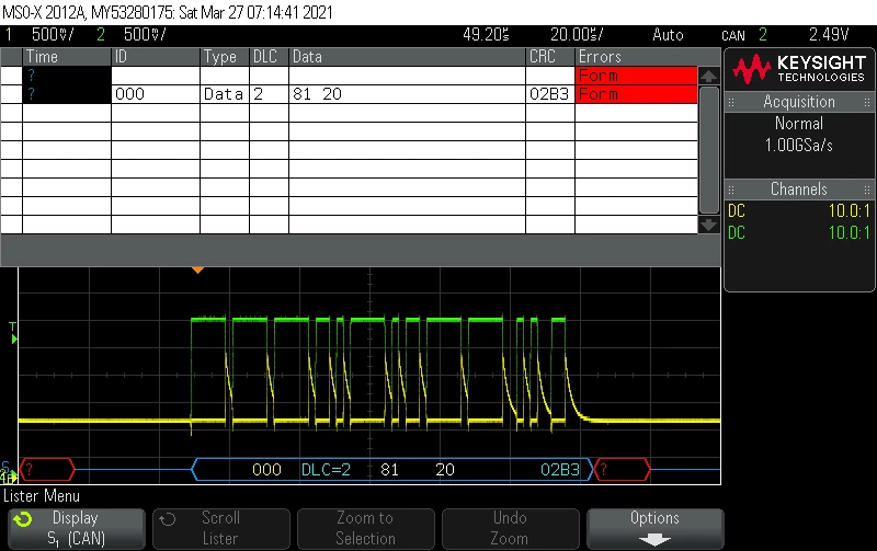

Now to my question. I'm having problems with the MCU's on the network going into silent mode and bus off mode. Using an oscilloscope I can see that there are frame errors that are causing the internal error counters to rise up past 127 for receive and 256 for transmit. I have included screen shots from the oscilloscope to show you what the wave forms look like.
0693W000008y4OsQAI.pngHere I'm getting form errors and I think the oscilliscope can't identify that bit. From what I understand about CAN that should be the acknowledge bit (?). The message being sent is a sync request message from the F4 to the F1's.

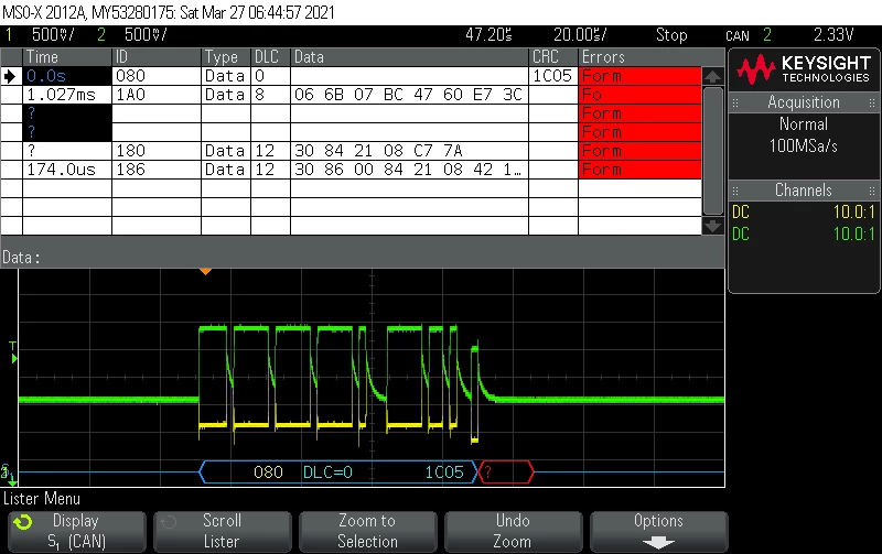

Below is another screen shot showing a response message to the sync. The response comes from a F1.0693W000008y4P2QAI.pngThe last bit looks very weird compared to the rest. Then the whole second message cannot be identified. I don't know enough about CAN to understand what is a happening.

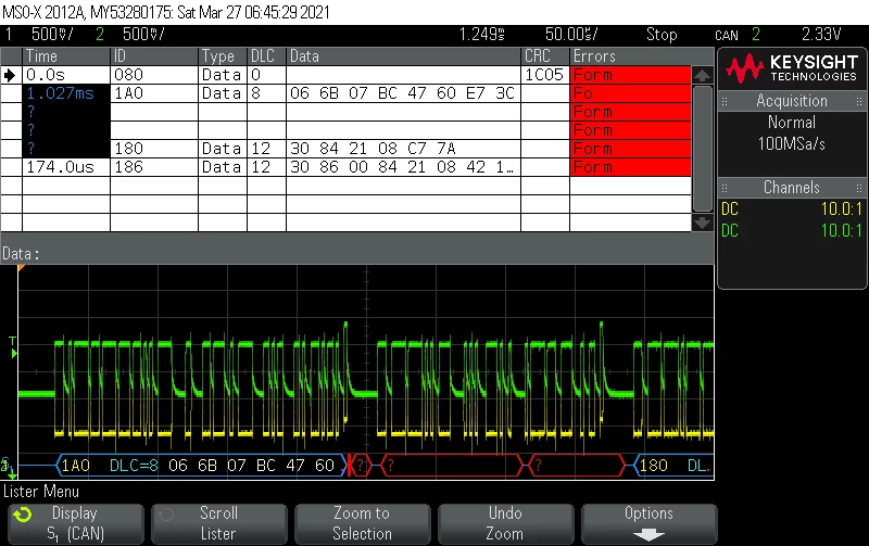

Below is another screen shot of the oscilloscope output. Here I have two F1's and one F4 connected to the network. This message was sent by one of the F1's. This one also has a form error
My final screen shot is a full sync response message with that weird last bit. This time the oscilloscope is able to decode the entire message. This leads me to think that the weird last bit isn't causing the form and frame errors.
