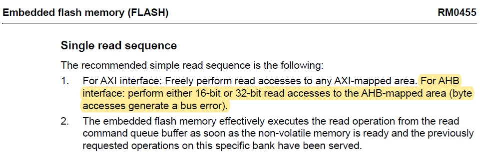

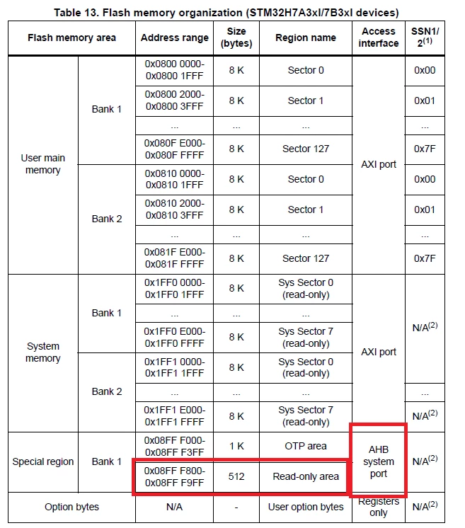

In fact the behavior is expected with STM32H7B/A devices (not the case of STM32H74x/5x/2x/3x), and this is described in the RM0455 / "Single read sequence" section:
Since the UID is located at the address 0x08FFF800 accessed by the CPU over AHB, it could not be accessed with byte but with half-word or word.

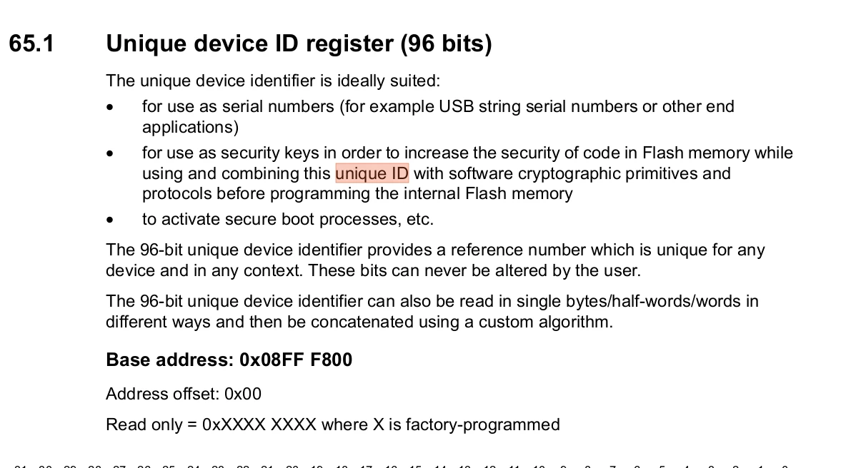

From RM0455:
And in your example you're accessing the UID with bytes:
 uint8_t* uid_base = (uint8_t*) 0x08FFF800;
 uint8_t i = uid_base[0];
