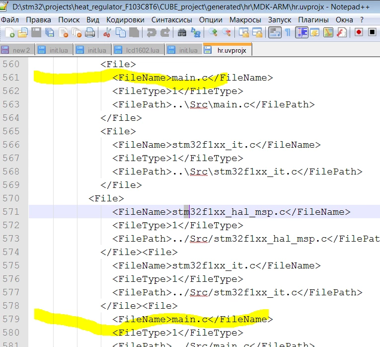

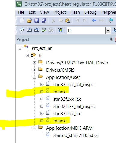

BUGREPORT STM32CubeMX 4.17.0 double entries for *.c files in keil project
  • October 31, 2016
  • 1 reply
  • 723 views
Posted on October 31, 2016 at 15:29
so looks project in keil:
here we see that entries doubles in .uvprojx :
Both project files attached.

    I have checked and generated the project using your .ioc: I do not see the issue that you have mentioned with Keil.
    You should clean your Target, check and set up properly the Include Paths, then try rebuild again.
    Please keep me informed with your issue state.
