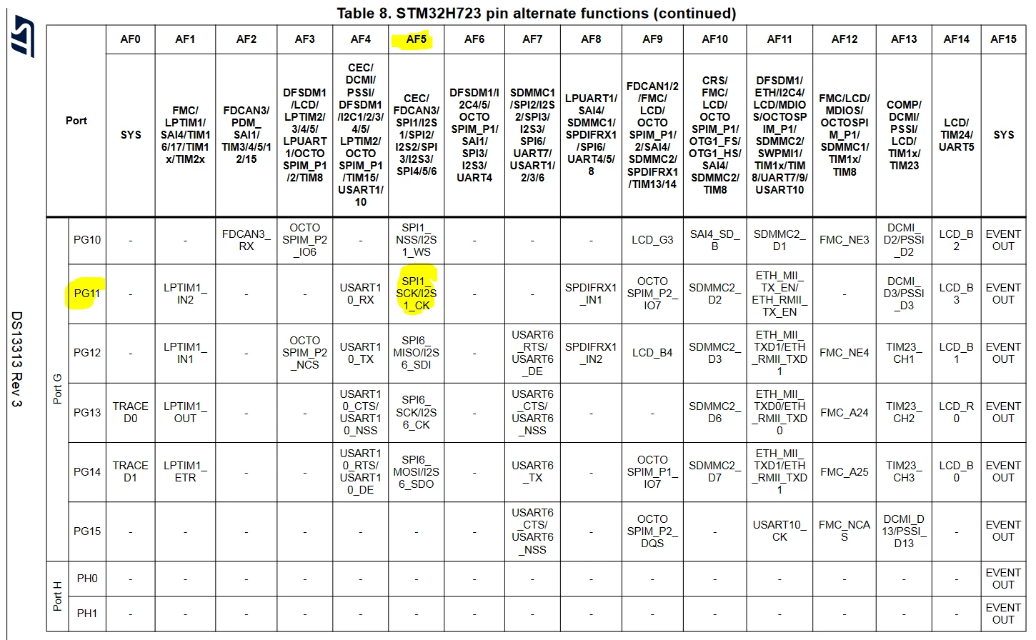

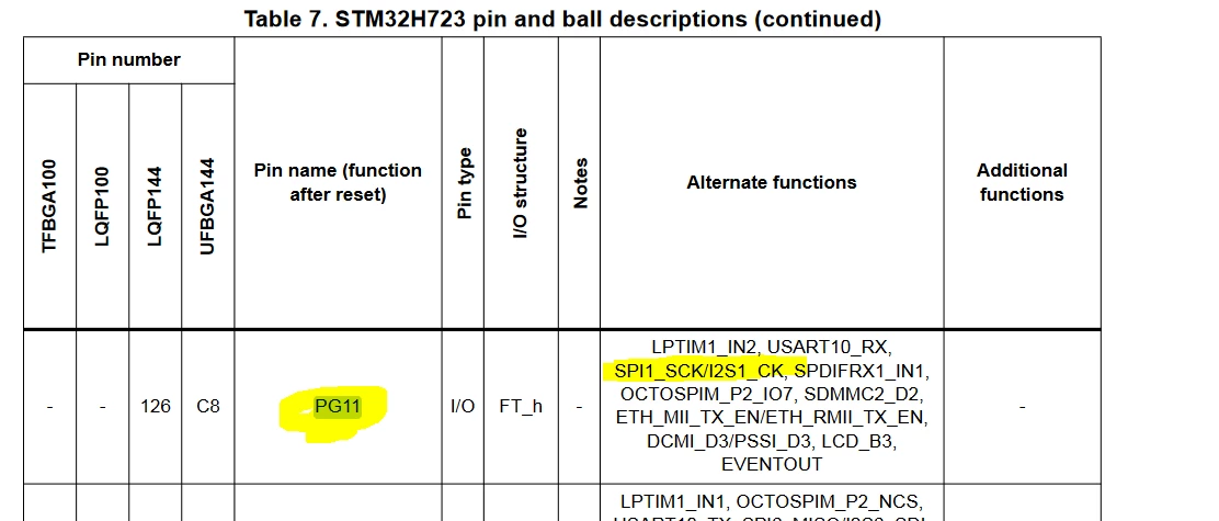

BUG with STM32H723ZGT6 in SPI1 SCLK on PG11 pin (missing)
I am making SPI DAC update function, and I could not get PG11 to output SPI1 clock.
While if I switch to PB3 pin, all is perfect. (this is alternate pin for SPI1)
If I toggle PG11 as GPIO, I get waveform so where is no short or something similar. Errata is also mute about this....
LL_AHB4_GRP1_EnableClock(LL_AHB4_GRP1_PERIPH_GPIOG);
LL_GPIO_SetPinMode(GPIOG, LL_GPIO_PIN_11, LL_GPIO_MODE_ALTERNATE);
LL_GPIO_SetAFPin_0_7(GPIOG, LL_GPIO_PIN_11, LL_GPIO_AF_5);
LL_GPIO_SetPinSpeed(GPIOG, LL_GPIO_PIN_11, LL_GPIO_SPEED_FREQ_HIGH);
LL_GPIO_SetPinPull(GPIOG, LL_GPIO_PIN_11, LL_GPIO_PULL_DOWN);
LL_GPIO_SetPinOutputType(GPIOG,LL_GPIO_PIN_11,LL_GPIO_OUTPUT_PUSHPULL);
This is don't work. I get low level all the time... But if I switch to PB3, all is great:
For pin 11, you want LL_GPIO_SetAFPin_8_15.
LL_GPIO_SetAFPin_8_15(GPIOG, LL_GPIO_PIN_11, LL_GPIO_AF_5);

Ahhh, as always, it's so obvious now..... It works,
Thank you for saving me a lot of time :smiling_face_with_smiling_eyes:

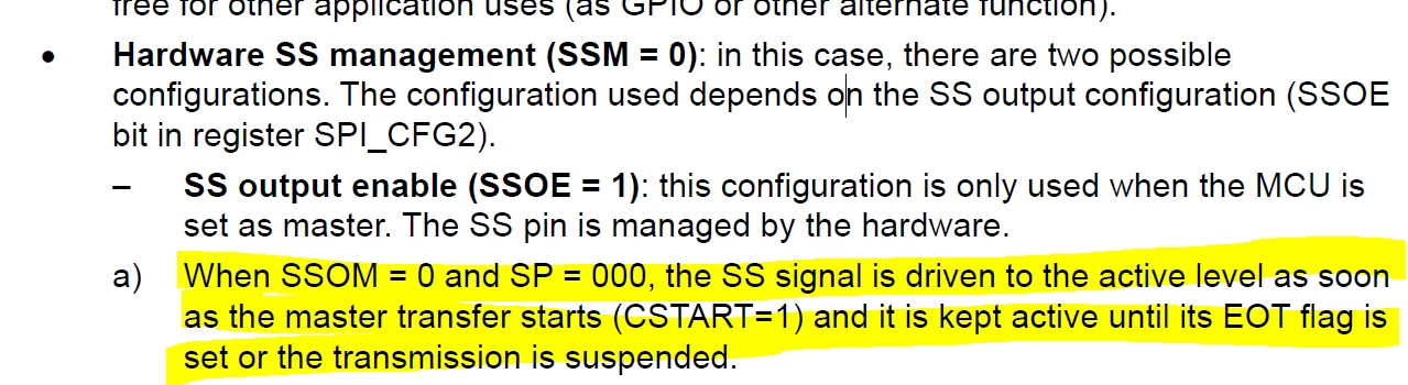

> I don't understand why ST can't include NSS hardware that would be handled with DMA transfers, it is just a few more triggers inside silicon to produce... NSS handling is just a mess.
The STM32H7 series has newer SPI peripheral where the SS pin can probably act as you want. Have you tried it?

I would love to ,
So changed:
spi_initstruct.NSS = LL_SPI_NSS_HARD_OUTPUT;
LL_SPI_SetNSSPolarity(SPI1,LL_SPI_NSS_POLARITY_HIGH); //Or low...
LL_SPI_SetTransferSize(SPI1,1);
LL_SPI_SetMasterSSIdleness(SPI1,2);
LL_SPI_Enable(SPI1);
LL_DMA_EnableStream(DMA1, LL_DMA_STREAM_7);
LL_SPI_StartMasterTransfer(SPI1);
And lets not forget PIN init:
 LL_GPIO_SetPinMode(GPIOG, LL_GPIO_PIN_10, LL_GPIO_MODE_ALTERNATE);
 LL_GPIO_SetAFPin_8_15(GPIOG, LL_GPIO_PIN_10, LL_GPIO_AF_5);
 LL_GPIO_SetPinSpeed(GPIOG, LL_GPIO_PIN_10, LL_GPIO_SPEED_FREQ_HIGH);
 LL_GPIO_SetPinPull(GPIOG, LL_GPIO_PIN_10, LL_GPIO_PULL_DOWN);
 LL_GPIO_SetPinOutputType(GPIOG,LL_GPIO_PIN_10,LL_GPIO_OUTPUT_PUSHPULL);
But I don't see any activity on NSS pin...
What I am doing wrong ?

I am very close, I can get single tranfer to DAC with correct timings and no software management, but still need to figure out how to re-trigger this with for DMA
 spi_initstruct.BaudRate = LL_SPI_BAUDRATEPRESCALER_DIV128;
 spi_initstruct.TransferDirection = LL_SPI_SIMPLEX_TX;
 spi_initstruct.ClockPhase = LL_SPI_PHASE_1EDGE;
 spi_initstruct.ClockPolarity = LL_SPI_POLARITY_LOW;
 spi_initstruct.BitOrder = LL_SPI_MSB_FIRST;
 spi_initstruct.DataWidth = LL_SPI_DATAWIDTH_16BIT;
 spi_initstruct.CRCCalculation = LL_SPI_CRCCALCULATION_DISABLE;
 spi_initstruct.Mode = LL_SPI_MODE_MASTER;
 LL_SPI_Init(SPI1, &spi_initstruct);
 LL_SPI_SetNSSPolarity(SPI1,LL_SPI_NSS_POLARITY_LOW);
 LL_SPI_EnableDMAReq_TX(SPI1);
After this I do DMA stuff
 LL_AHB1_GRP1_EnableClock(LL_AHB1_GRP1_PERIPH_DMA1);
 NVIC_SetPriority(DMA1_Stream7_IRQn, 0);
 NVIC_EnableIRQ(DMA1_Stream7_IRQn);
 LL_DMA_ConfigTransfer(DMA1,LL_DMA_STREAM_7,LL_DMA_DIRECTION_MEMORY_TO_PERIPH | LL_DMA_PRIORITY_MEDIUM | LL_DMA_MODE_NORMAL |LL_DMA_PERIPH_NOINCREMENT | LL_DMA_PERIPH_NOINCREMENT |LL_DMA_PDATAALIGN_HALFWORD | LL_DMA_MDATAALIGN_HALFWORD);
 LL_DMA_ConfigAddresses(DMA1,LL_DMA_STREAM_7,0x24000000, (uint32_t) &(SPI1->TXDR),LL_DMA_GetDataTransferDirection(DMA1, LL_DMA_STREAM_7));
 LL_DMA_SetDataLength(DMA1, LL_DMA_STREAM_7, 1);
 LL_DMA_SetPeriphRequest(DMA1, LL_DMA_STREAM_7, LL_DMAMUX1_REQ_SPI1_TX);
 LL_SPI_SetInterDataIdleness(SPI1,2);
 LL_DMA_EnableIT_TC(DMA1, LL_DMA_STREAM_7);
 LL_DMA_EnableIT_TE(DMA1, LL_DMA_STREAM_7);
And when I trigger DMA:
