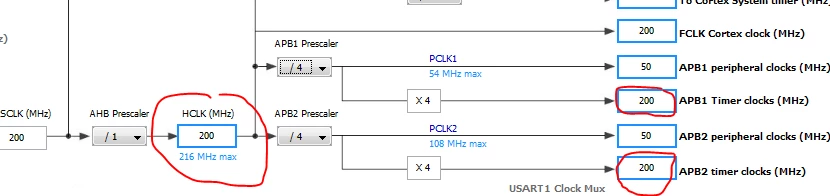

it seems cube does not take care of time TIMPRE x4 multiplier for the AHB1 timer clock

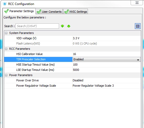

    Please make sure that theTIM Prescaler selection is enabled from RCC configuration tab:

    thanks for the hint. However when setting the frequency field for AHB1 timer clock to 200 Mhz, cube tries hard to find a solution, but does not come up with the  'TIM Prescaler selection from RCC configuration'.

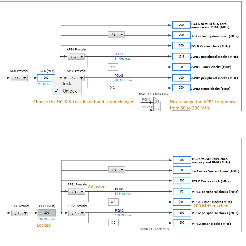

    Please note the following feature on CubeMX clock tree. By right clicking the clock tree, you can lock a value you want to remain unchanged (HCLK here), then to reach 200MHz for the timer the timer pre-scaler will be adjusted fine0690X00000608YLQAY.png.
