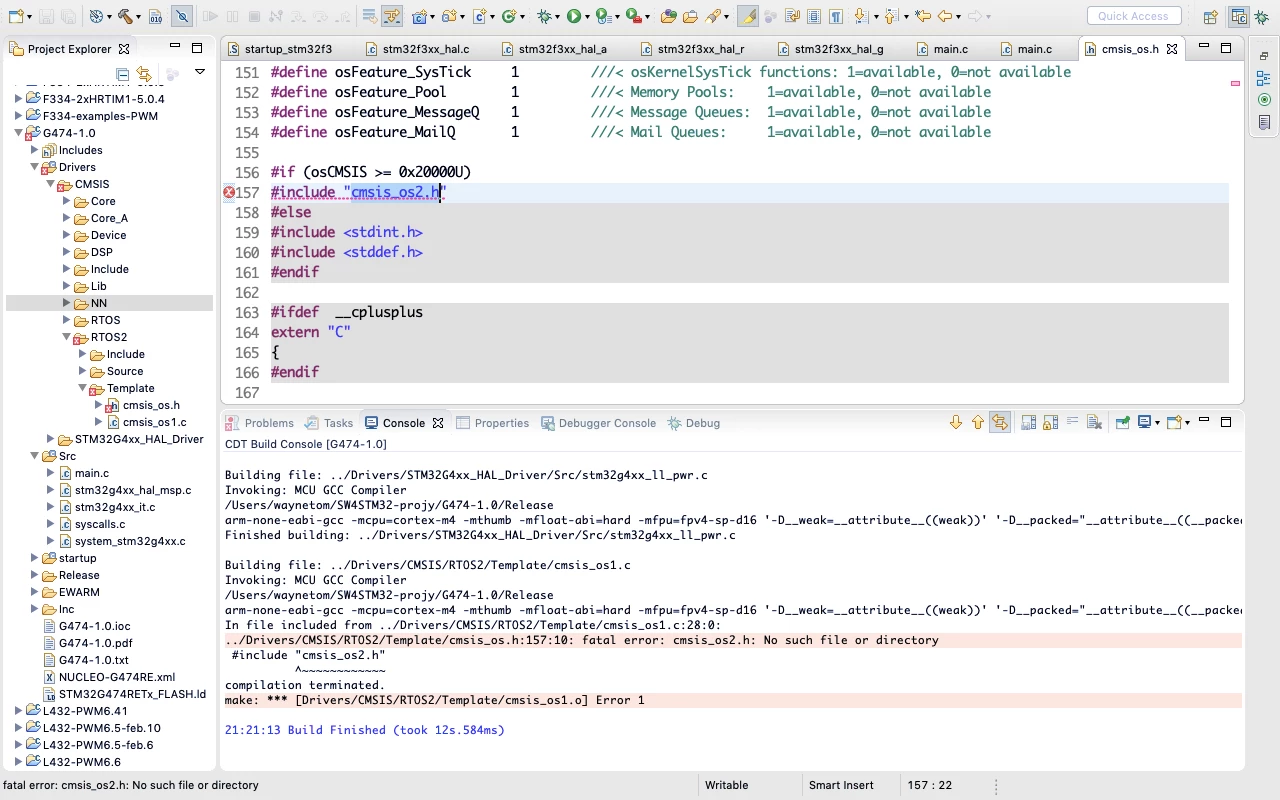

BUG: SW4STM32 won't compile Nucleo-STM32G474 : get a fatal error: cmsis_os2.h: No such file or directory . See attached screen shot).

Making a port from F334 to G474 controller, used CubeMx 5.3 to do 1 PWM using HRTIM CHA 50% duty as a test and got a this error during compile.
Best answer by WTom
I found the problem. It got somehow linked into the wrong IDE from the CubeMX as the selected IDE was EWARM instead of SW4STM32.

WTomAuthorBest answer
August 13, 2019

MHanc.1
Visitor II
May 12, 2023
Just in case somebody runs in this issue. Had the same problem with version 6.8.1.
The problem is caused by the default toolchain setting, which is EWARM. If you change to STM32CubeIDE later, the files of EWARM project will not be deleted and are causing above problem.
Workaround - delete all files in folder except the .ioc file. Then open .ioc with MX, select correct toolchain (STM32cubeIDE) and re-generate the project files.
