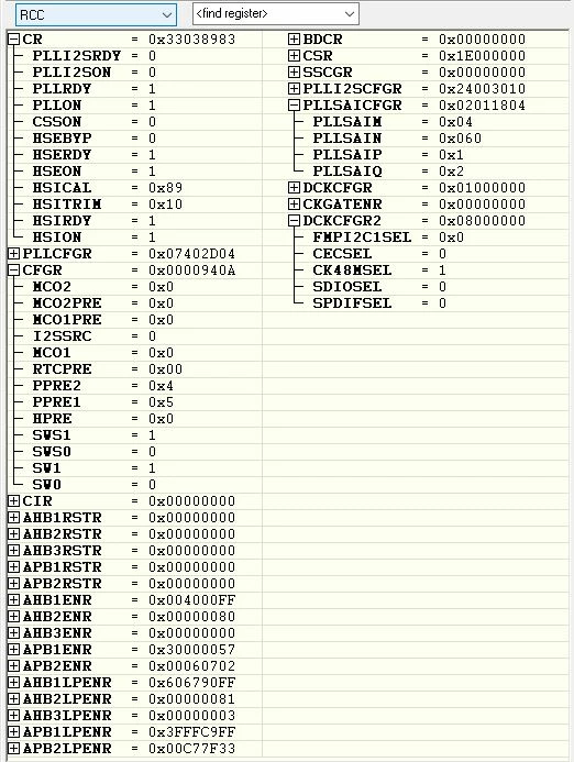

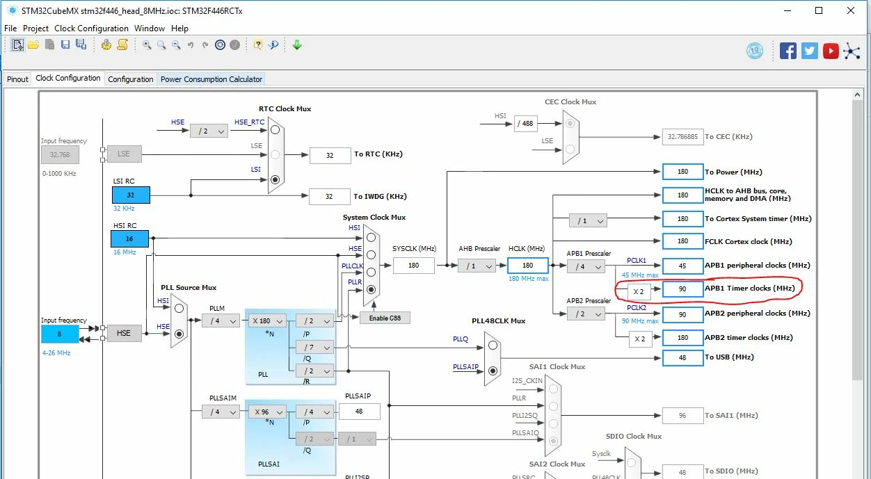

    Ok, here is some additional information.
    Debugging has been done with TIM4 which is on APB1.
    APB1 clock is mentioned by Cube MX to be 90MHz. Following the reference manual this should be right.
    RCC configuration with this application:
    In the picture above it can be seen that the bit CK48MSEL is present for this micro (second bug mentioned). I use the USB and it is working correctly which proves it.

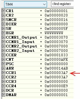

    Here are the registers of TIM4:
    TIM4 CCR4 is set to 0x03A7 = 935. For the pulse length this would be 1/90E+06 x 936 = 10.4 micro seconds.
    Measuring with a scope on the output gives HALF this time:
    This means that the clock on the APB1 timers is not X2 but X4 the 45MHz.
    Hope this is enough information.
