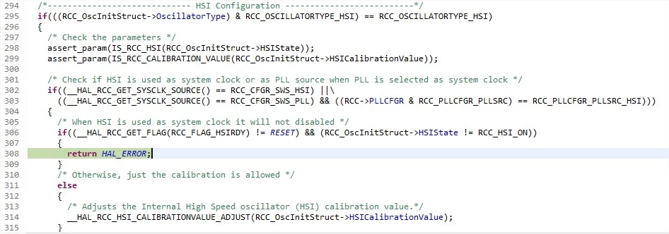

Hi Everybody
Developing code for STM32F427 I decided to use CubeMX. It was not the first time when I found the tool useful to start the project but the first time when I noticed a problem with the output configuration files, especially with RCC configuration.
Please find the following code into your main.c file:
  RCC_OscInitStruct.OscillatorType = RCC_OSCILLATORTYPE_HSI | RCC_OSCILLATORTYPE_HSE;
  RCC_OscInitStruct.HSEState = RCC_HSE_ON;
  RCC_OscInitStruct.PLL.PLLSource = RCC_PLLSOURCE_HSE;
  RCC_OscInitStruct.PLL.PLLM = 8;
  RCC_OscInitStruct.PLL.PLLN = 180;
  RCC_OscInitStruct.PLL.PLLP = RCC_PLLP_DIV2;
  RCC_OscInitStruct.PLL.PLLQ = 3;
    Error_Handler();
The function HAL_RCC_OscConfig returns with HAL_ERROR.
To run the program properly I had to remove RCC_OSCILLATORTYPE_HSI from the first line of the code above.That was the only modification. No more changes were made.
IDE: TrueSTUDIO
MCU and firmware package:
Is this a bug, or I did something wrong?
Artur

    Posted on March 31, 2017 at 12:55
    Hi
    trybula.artur
    This is a confirmed bug; It will be fixed througha patch which will be delivered soon.
    Sorry for any inconvenience this may have caused.

    Posted on April 05, 2017 at 16:55
    Hi
    trybula.artur
    I would inform you that a new patch
    /external-link.jspa?url=http%3A%2F%2Fwww.st.com%2Fcontent%2Fst_com%2Fen%2Fproducts%2Fdevelopment-tools%2Fsoftware-development-tools%2Fstm32-software-development-tools%2Fstm32-configurators-and-code-generators%2Fstm32cubemx.html
    is now available on ST website. The issue is fixed.

    Posted on April 06, 2017 at 10:04
    Hi
    garsi.khouloud
    Thank you for the info.
