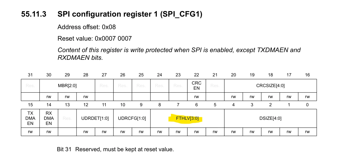

In some places the register name "FTHLV" is typed wrong:
The right register name is "FTHLV":

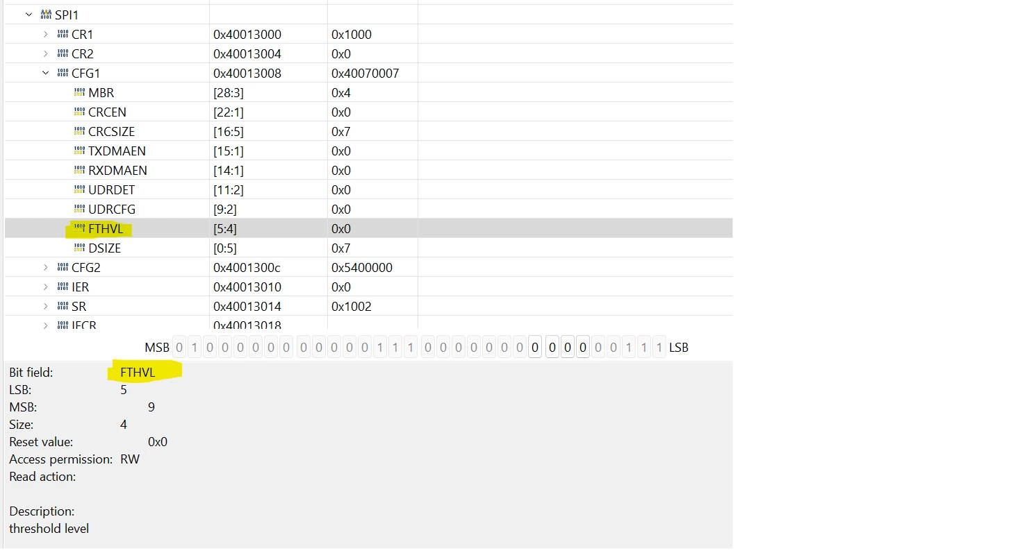

In STM32 CubeIDE the name is wrongly spelled "FTHVL":

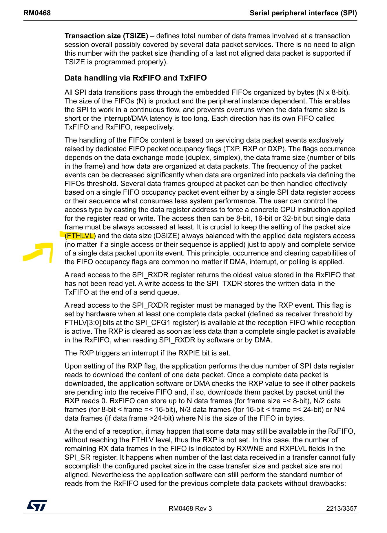

In the Reference Manual RM0468 (Page 2227) it is one time called "FTHLVL":

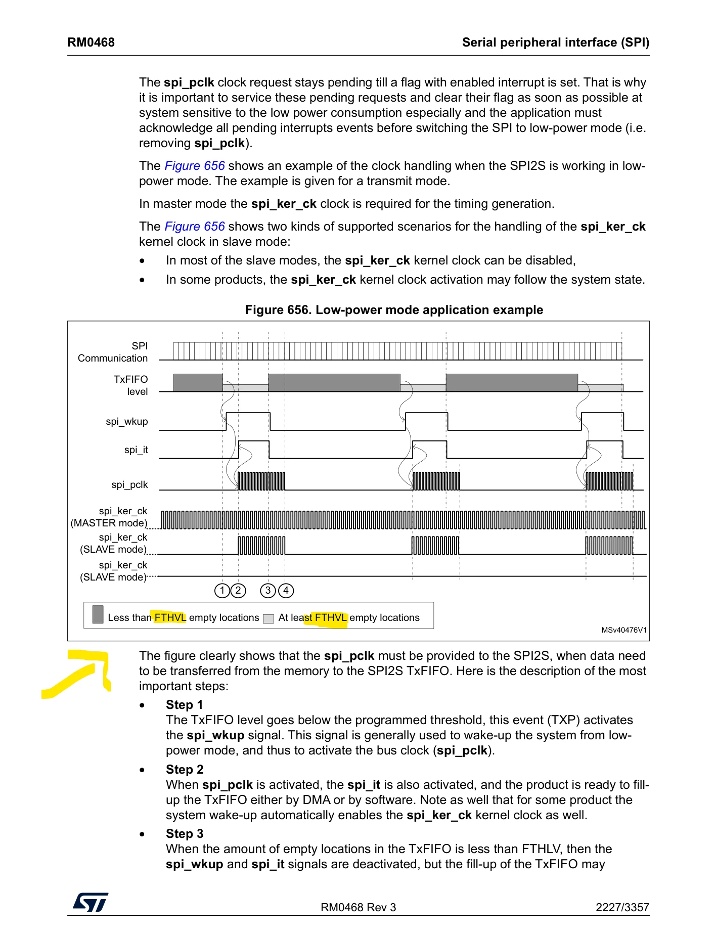

And in another Diagram (Page 2213) "FTHVL":
Best answer by Diane POMABIA
An update will be done on next revision or Reference Manual.
Regards
Diane

Hello @DB.7ecker​
Thanks you for repporting this bug .
I reported this bug to concerned team.
Regards
Diane
