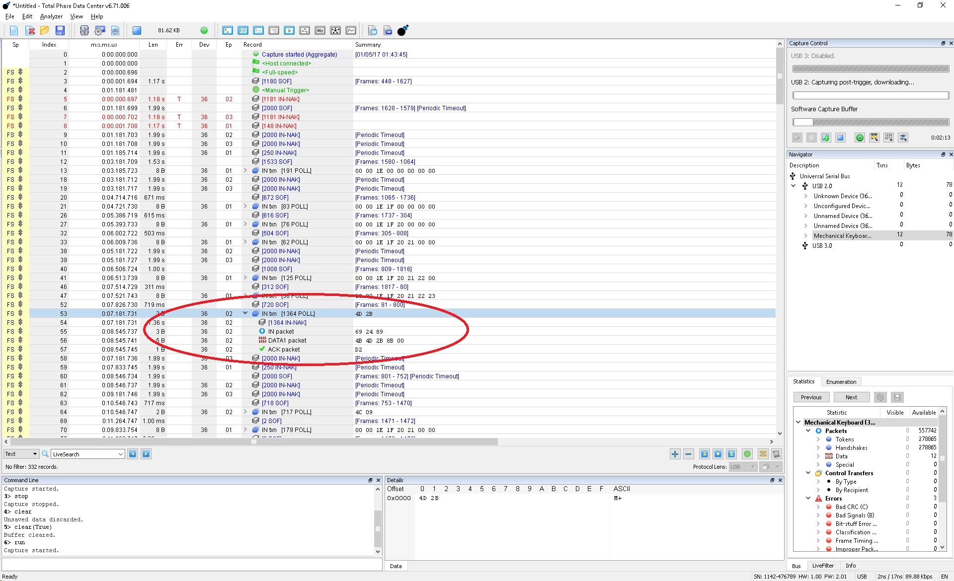

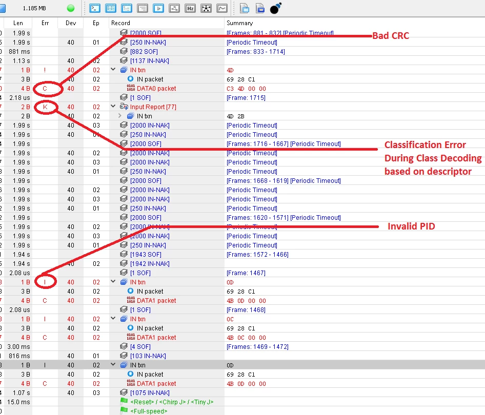

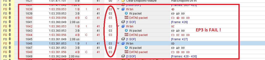

    I have the same issue it seems, It is very serious. Debugged this for quite a while until i found this post here.
    I amalso getting bad transfers on EP2 (and possibly any of the higher EP1 above 1) and have it traced down to exactly this function to be called with the correct data being supplied. 16 Byte Buffer is defined but only 2 reach the PC and it is totally wrong data. Sometimes the Beagle 5000 reports bad CRC as well. EP1 is all ok.
    Here is what I see in the USB Analyzer:
    This is what is called:

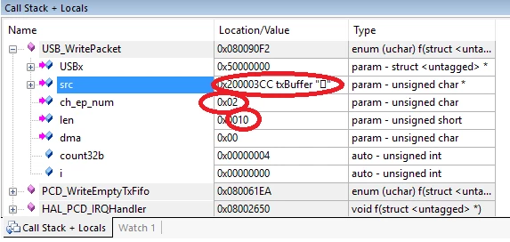

    USBx_DFIFO(ch_ep_num) = *((__packed uint32_t *)src);�?
    And here is the Route Call Stack just before the sent:

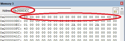

    And Finally here is the Buffer to Send:
    For the Report descriptor it is fine, it works on many commercial products we did.
    So based on the above suspicion in the original post i changed to this :
    __disable_irq(); USBx_DFIFO(ch_ep_num) = *((__packed uint32_t *)src); __enable_irq();�?�?�?�?
    But it does not help, still the same:

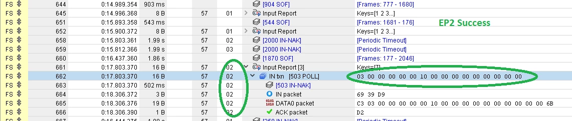

    If I try the same thing via EP3 it also fails:

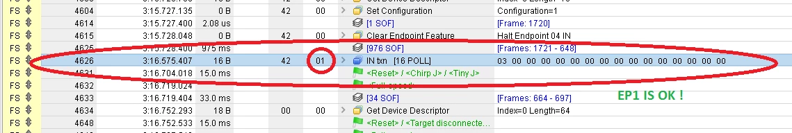

    But if I specify EP1 in my send routine (illegally, of course just for test) :
    At this point I have serious doubts, it is not the user code, but either it is something not setup correctly in the LIB when opening the higher EP (I did have to set the TxFifo Manually) or it is something in the USB Engine itself that goes wrong.

    I have now found a workaround to this issue:
    I am pretty sure it is an issue with the IC and the Library. If anybody else is facing this problem, I have already used my customer channel to report and there is a workaround document from ST which I don't have as of now, but basically they said it will be worked around in the next Update of the Cube.
    If anybody else needs a quick fix the problem is the allocation of the FiFoTxBuffer. The library allocates to much buffer (2x) and interferes with the next EP due to this somehow. I do not know if this is a design issue (as ST claims) or just a bug that there isn't that much Fifo and corrupts other EP registers in the chip. In my case in order not to edit the library I have reduced the TxBuffer accordingly.

    Update: I have now gotten the Document from ST but this is unrelated, it does not solve this issue. The document is per the original suspicion in this thread by Johannes Lange, but this is not the actual root cause of the corruption as disabled Interrupts or flags do not help. First of all this function is only called from an interrupt in the Library and blocking other interrupts does not change the problem at all. hanging the FiFo Size itself however does solve this issue.
