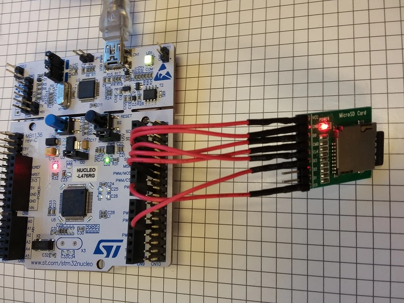

\STM32Cube_FW_L4_V1.0\Drivers\BSP\Adafruit_Shield\stm32_adafruit_sd.c
Issue with ReadBlocks/WriteBlocks on SDHC cards, offset advances in BlockSize!!! ReadAddr should increment by 1. The current routine delivers junk for multi-sector reads/writes. Please, please, test these things, wasted a lot of time chasing this to ground.
Original code
response = SD_SendCmd(SD_CMD_READ_SINGLE_BLOCK, (ReadAddr + offset) * (flag_SDHC == 1 ? 1: BlockSize), 0xFF, SD_ANSWER_R1_EXPECTED);
/* Set next read address*/
offset += BlockSize;
Suggested fix (I'd probably refactor completely)
response = SD_SendCmd(SD_CMD_READ_SINGLE_BLOCK, ReadAddr * ((flag_SDHC == 1) ? 1: BlockSize), 0xFF, SD_ANSWER_R1_EXPECTED);
ReadAddr++; // Block Address

    Posted on February 04, 2018 at 16:57
    Large f_read()/f_write() used against the FatFs library will propagate to the DISKIO layer as reads/writes where count>1
    Failure can be observed in a file CRC routine if  >=1024 byte blocks are read vs 512 byte blocks. Different CRC values will be observed in 512, 1024, 4096-bytes/block, etc, passes of the file.

    There is a problem with sd_spi implementation in stm3210c-eval-bsp/stm3210c_eval_sd.c The fix related to thread is applied only on Drivers/BSP/Adafruit_Shield/stm32_adafruit_sd.c not on evalboard BSP. Please fix this.

    Posted on March 15, 2018 at 12:18
    Hi Clive,
    The issue you highlighted was reported internally and confirmed. The fix will be available in coming versions of the STM32CubeL4 package.

    Hi @Community member​ ,
    Please note that a fix is applied to BSP_SD_ReadBlocks and BSP_SD_WriteBlocks in order to support SDHC cards. Updated stm32_adafruit_sd.c is available in the last version of STM32CubeL4 package (1.12.0) .
