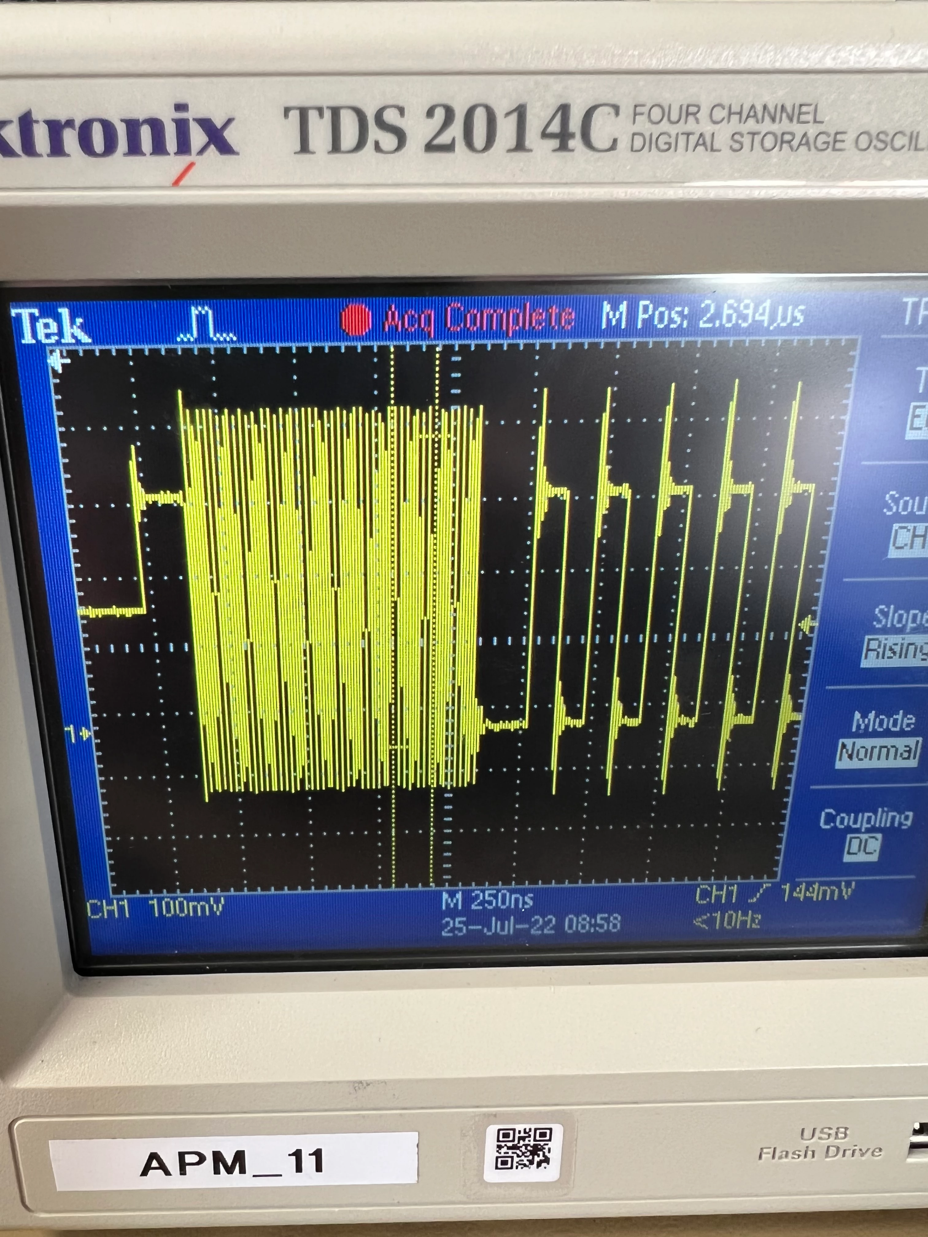

Hi I'm trying to generate a signal with 100 ns time on and 100 ns time off thanks to DMA transfer. My problem is that I have a peak of tension before and I don't know what is it (F446RE)
0693W00000QM2iNQAT.jpgHere is my code:

Best answer by YSall.1
I found the problem -> set pin to no pull up no pull down and -> Enable alternate fucntion of pin and timers at the end of all initialisations
 TIM2->CR1 |=CR1_CEN;
 DMA1_Stream1->CR|= (1<<0);
 GPIOA->AFR[0] |=AFR5_TIM;

KnarfB
July 25, 2022
Debug your code step by step with the scope connected and find which statement causes what behaviour.
Btw, I don't see a reason for using DMA for such a regular waveform, but you might have your reasons.

YSall.1AuthorBest answer
Senior
July 27, 2022
