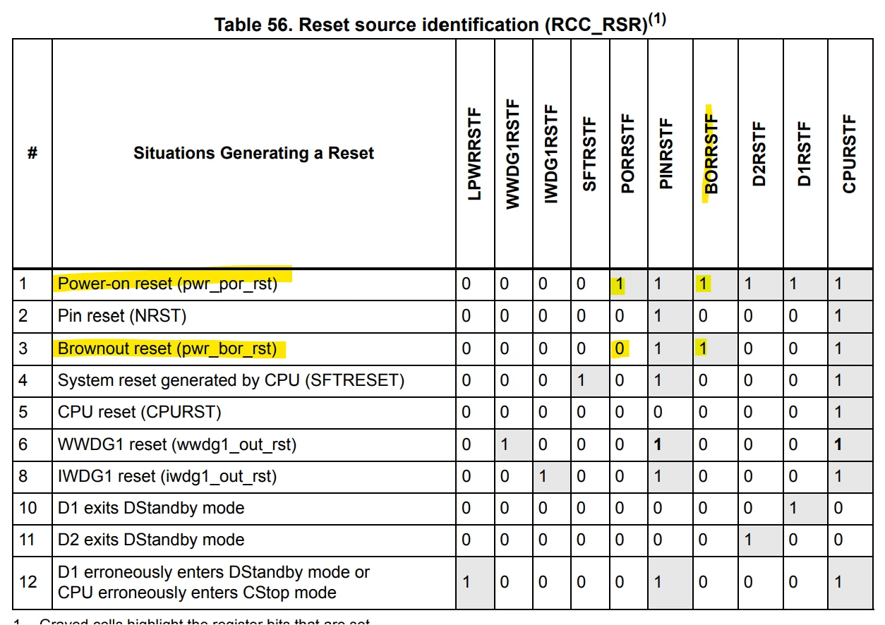

I am using STM32H753ZI for my project. My use case is I want to detect brown out reset after brownout occurs and system restarts.
I am checking brownout reset flag using
 if (__HAL_RCC_GET_FLAG(RCC_FLAG_BORRST). My query is this flag is shared/common between Power On Reset and Brown Out Reset i.e POR/PDR or BOR same as like in STM32F779NI?

The reference manual tells you which bits are set in various scenarios. For BOR reset, BORRST is set and PORRST is not set. For POR reset, both are set.
