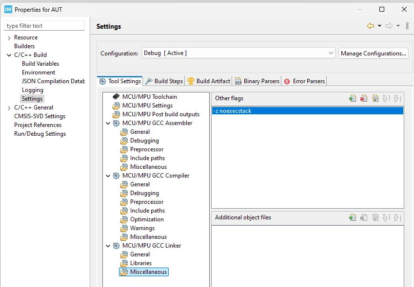

- Generated IOC project with CubeMX for CubeIDE.
- Does not link correctly in CubeIDE, had to add "-z noexecstack"
C:/ST/STM32CubeIDE_1.17.0/STM32CubeIDE/plugins/com.st.stm32cube.ide.mcu.externaltools.gnu-tools-for-stm32.13.3.rel1.win32_1.0.0.202411081344/tools/bin/../lib/gcc/arm-none-eabi/13.3.1/../../../../arm-none-eabi/bin/ld.exe: warning: C:/ST/STM32CubeIDE_1.17.0/STM32CubeIDE/plugins/com.st.stm32cube.ide.mcu.externaltools.gnu-tools-for-stm32.13.3.rel1.win32_1.0.0.202411081344/tools/bin/../lib/gcc/arm-none-eabi/13.3.1/thumb/v8-m.main+fp/hard/crtn.o: missing .note.GNU-stack section implies executable stack
C:/ST/STM32CubeIDE_1.17.0/STM32CubeIDE/plugins/com.st.stm32cube.ide.mcu.externaltools.gnu-tools-for-stm32.13.3.rel1.win32_1.0.0.202411081344/tools/bin/../lib/gcc/arm-none-eabi/13.3.1/../../../../arm-none-eabi/bin/ld.exe: NOTE: This behaviour is deprecated and will be removed in a future version of the linker

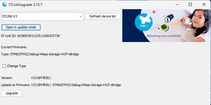

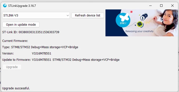

- Build runs, tried to run, the programmer says I have to upgrade the firmware of the Nucleo STLINK.
- Open in upgrade mode, runs correctly.

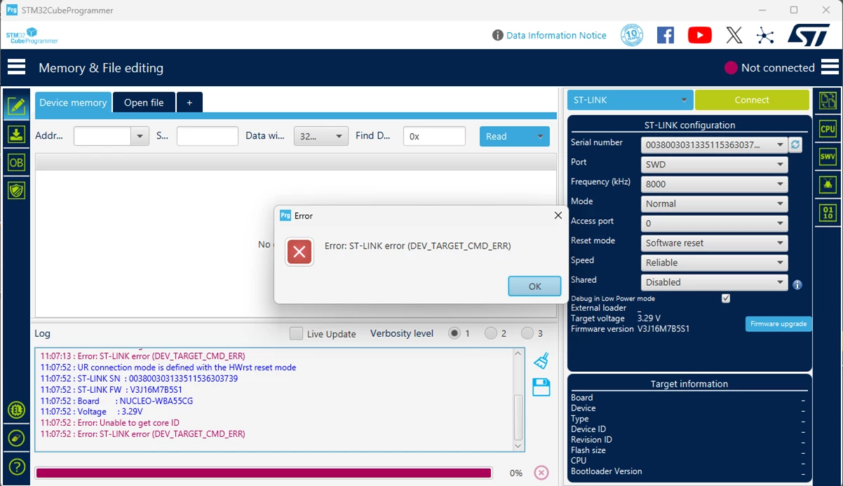

Back in Programmer,
For the record, I was able to connect before the upgrade + flash.
The upgrade mode seems to work still.
Now both boards show all LEDs on continuously.

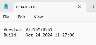

When I open the simulated USB drive,
Any help?

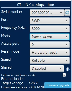

CarlosMartinezBest answer
Mar 5, 2025 10:38 AM UTC
Solved by programming with option "Power down"
1 reply
CarlosMartinezAuthorBest answer
