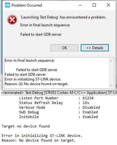

Bricked After first Debug STM32H735G-DK
I bought this kit to learn but after first time debugging i can't connect to it at all.
I just set some GPIO input and outputs and got a led working in debug mode and now i can't connect to the board again and the previous debug program doesn't work either.
I didn't choose the project from boards selection but from MCU selections
Which is STM32H735IG
Please help it was a very expensive board and i don't want to give up on learning it.

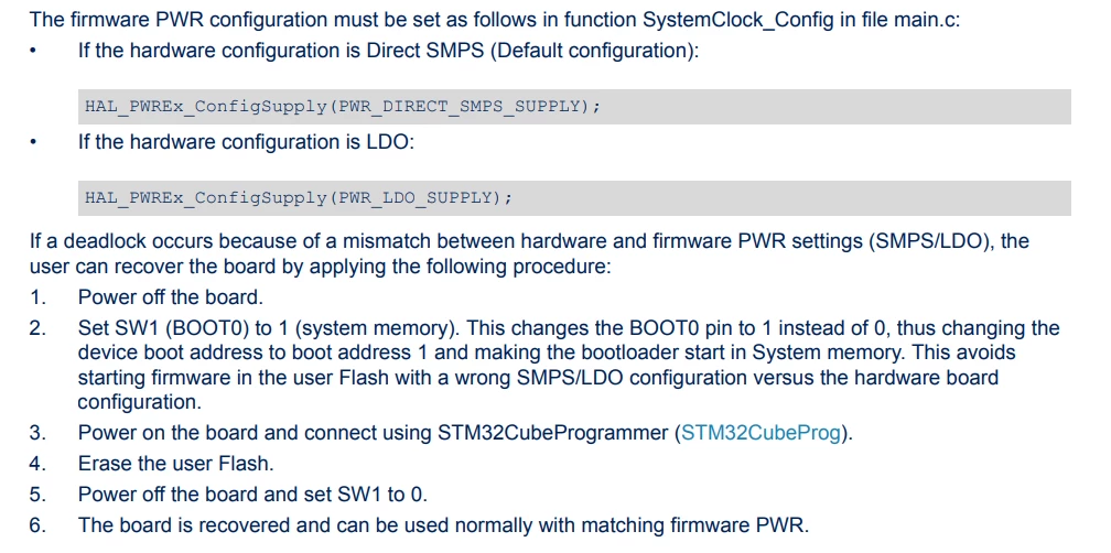

https://community.st.com/s/question/0D53W00000LeYL1SAN/get-stm32h735gdk-out-of-deadlock
Got to get the BOOT0 pin HIGH, cycle power a couple of times and then erase your broken code.​
L​ikely the wrong LDO/SMPS or VOS settings.

Can i ask how do we know at which sector our code is ? I just erased sector 0 and it worked but still not sure...
Also do you know if full erasure of chip would have any negative effect ?
In default code it seems the PWR Selection bits were wrong also.
Tesla DeLorean
Guru
Oct 29, 2020 9:04 AM UTC
The flash has got over 10K cycles, so unless you're doing some epic amount of compile/debug it is probably going to outlast you.
The flash maps to two addresses on the H7, the M7 core typically starts from 0x08000000 and the M4 from 0x08100000
E​rasing the first sector is sufficient to remove the vector table and stop your code running.
