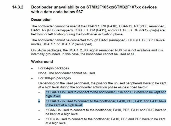

Hello!
currently looking into bootloader modes and working with the STM32F7.
while going over the AN2606 document (STM32 microcontroller system memory boot mode)
i noticed an issue - 'Bootloader unavailability on STM32F105xx/STM32F107xx devices with a date code below 937'
(a capture of the issue from the doc ument is attached).
i want to make sure that the document i've read is updated and that the F7 series does not have similar issues.
thank you!

    Posted on May 17, 2018 at 14:36
    Last version of the doc from Feb 2018, so assume data in it is relatively fresh, F7 been around for 3-4 years?
    http://www.st.com/content/ccc/resource/technical/document/application_note/b9/9b/16/3a/12/1e/40/0c/CD00167594.pdf/files/CD00167594.pdf/jcr:content/translations/en.CD00167594.pdf
