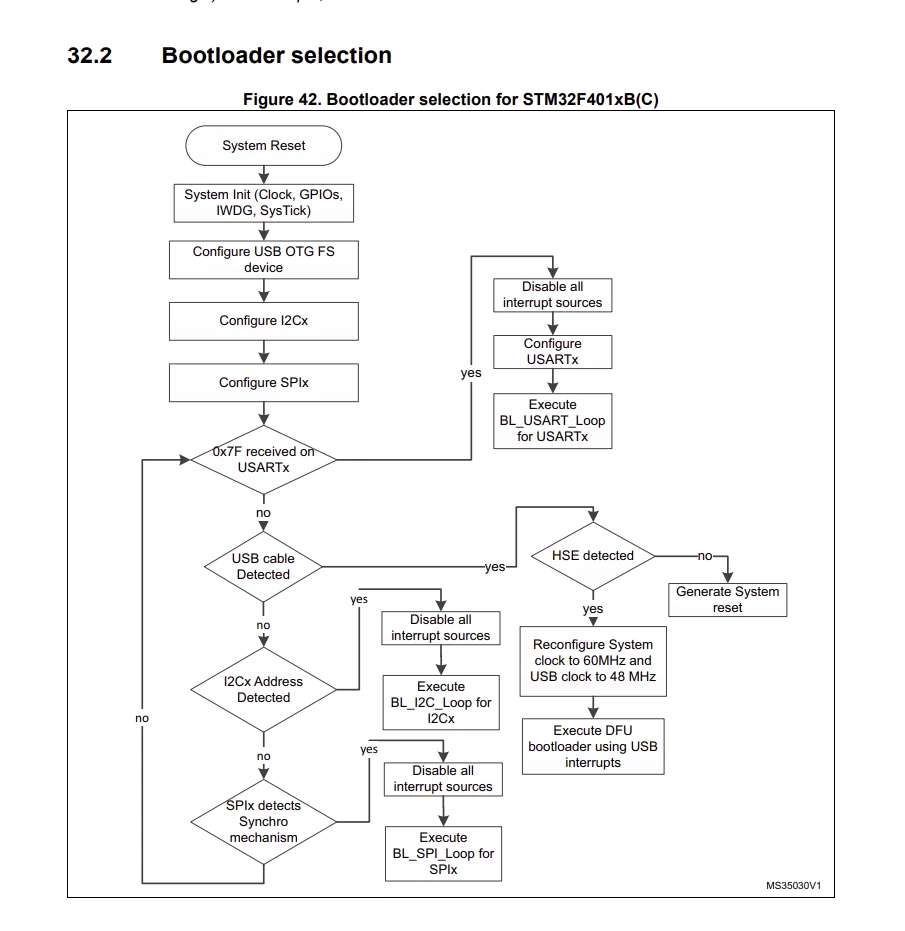

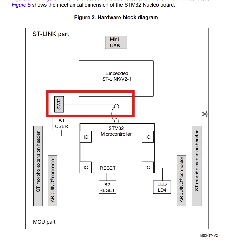

The Hardware Layout for my Nucleo board also states that ST-Link is only available over SWD. Could it be that the system bootloader doesn't actually start SWD?
In AN2606 I don't see any mention of SWD being available in sys bootloader:

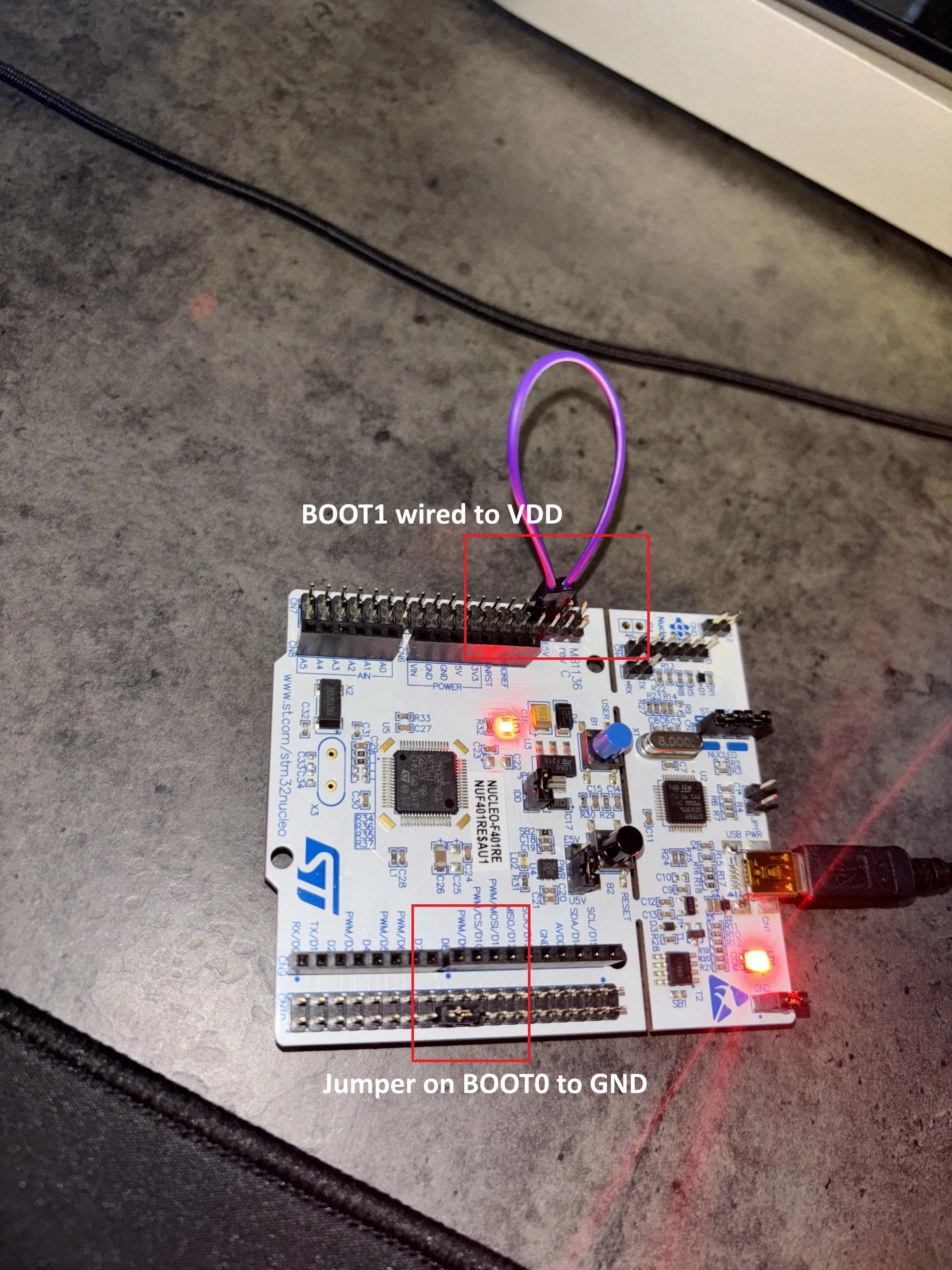

If useful, here is my setup:
Thanks in advance for any insight!!
No, SWD is part of the cortex core, not the bootloader. The only way to disable it would be to set RDP 2.
