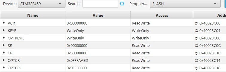

I can check the FLASH peripheral registers via STM32CubeProg, and they all look OK.

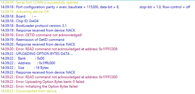

However, when I reset my board with BOOT0 set high, and attempt to connect via UART, I get this:
I also get four popup error boxes:
1. Initialising the Option Bytes failed
2. Uploading Option Bytes bank 0 failed
3. READ command not acknowledged at address: 0x1fffc000
4. READ command not acknowledged at address: 0x1fffx008
You can see from the above dump that the Bootloader is operational and connected, but is not responding correctly.

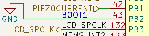

I have grounded BOOT1:

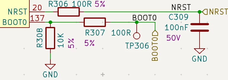

BOOT0 is connected to an external interface:
And to enter the Bootloader, I simply apply 3.3V to BOOT0 and reset the target.

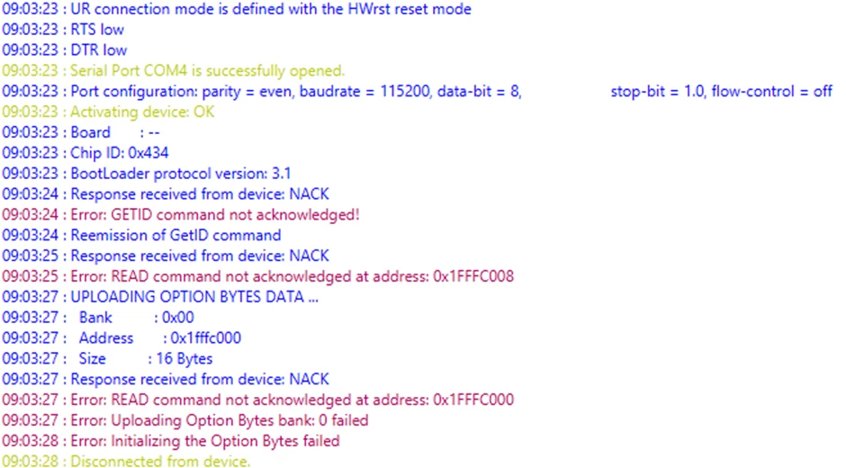

I think I know what is going on here:
I analysed the serial comms, and there was an additional 0x7f at the start. So the sequence was
PC->Target = 0x7f
Target->PC = 0x79 ACK
PC->Target = 0x7f - THIS IS SPURIOUS
Target->PC = 0x1f NACK
After this, it all falls over. There are also some badly framed bytes being sent by the PC.
I checked with an Nucleo-F429 that I had lying around, which worked correctly.
I checked logic levels and signal integrity with the oscilloscope, everything looked perfect.
Eventually I switched the USB-RS232 converter from an MCP2200 (Microchip) to a CP2101 (SiLabs), and everything seems to be working (as far as I have tested it - it's getting late!). I can connect, maintain a connection, perform a mass erase and download an image.
