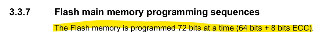

I want to flash my STM32L452RET6P using a .hex file. I am however struggling with the fact that STM IDE generates a .hex file with lines with only one WORD instead of the only supported double WORD when writing. So I need to buffer and assemble each double WORD from the .hex file. This involves a lot of tinkering for me, as in: how to buffer, how to know for sure we can finally write and so on. So is there any way to write only one WORD?

You cannot write less than a double word to flash. This is a hardware limitation due to the presence of ECC bits for the flash.
(A double word is written by writing two consecutive words, but don't mistake this for the ability to write a single word independently.)
If the hex file is consecutive, which is likely, you should be able to write words as they appear in the hex file, and if the next word isn't present, write a buffer word to complete the double word.

This explains clearly why the answer on my question is no.
About the hex file, does STM have strict guidelines how they generate them? I can use your solution to just consecutively write the hex file, but if for some reason it doesn't quite follow that guideline, I'm stuck again.
