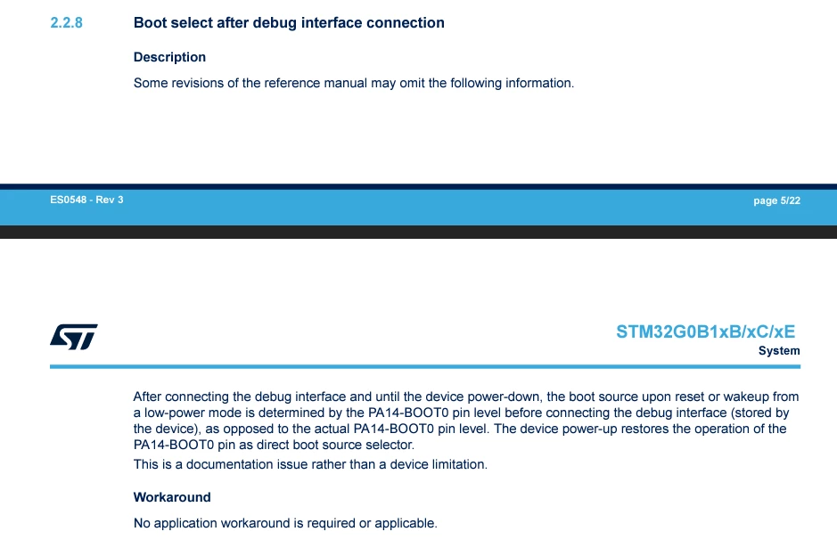

Stefano UgoliniBest answer
Sep 13, 2024 11:53 AM UTC
The issue was caused by the debugger as stated in the Errata sheet document.
https://www.st.com/resource/en/errata_sheet/es0548-stm32g0b1xbxcxe-device-errata-stmicroelectronics.pdf

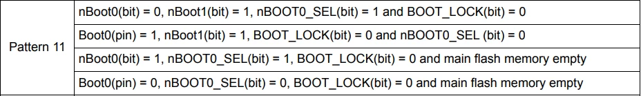

Hello @Stefano Ugolini
To activate bootloader on your MCU, you have to follow one of the 4 configurations mentioned on the Pattern 11 of the AN2606:
Best Regards.

Hi @STTwo-32 ,
thank you for the reply,
I am applying pattern 11, second raw, but the bootloader is not activated.
Other users reported a similar issue on the same family.
https://community.st.com/t5/stm32-mcus-embedded-software/stm32g070-entering-system-bootloader-mode-with-the-boot-pin/td-p/78972
Could you please check internally if there is an issue with the activation of the bootloader for the STM32G0C1 family?

Stefano Ugolini
Stefano UgoliniAuthorBest answer
