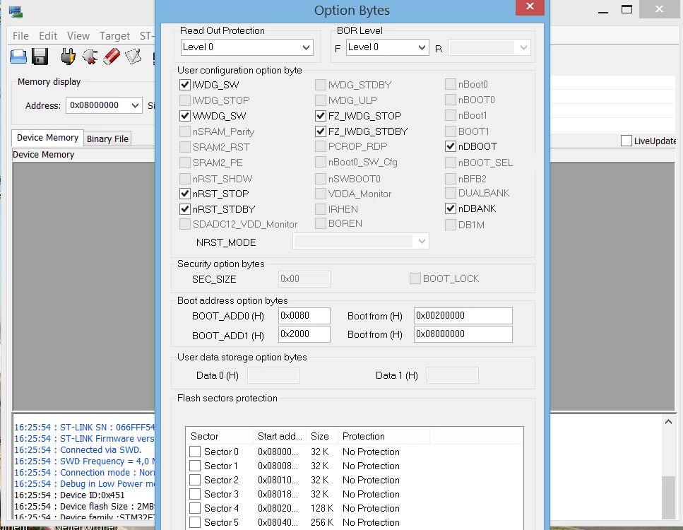

Case 1:
BOOT Pin =High;
BOOT_ADD1 = 0x2000 (Boot from 0x 08000000) (set via ST-LINK Utility)
In this case, the MCU doesn’t go into boot mode. So I can’t flash the MCU via UART
After Reset the user code starts directly (LED is blinking) and I have no chance to update the MCU because the MCU doesn’t go to the boot mode.

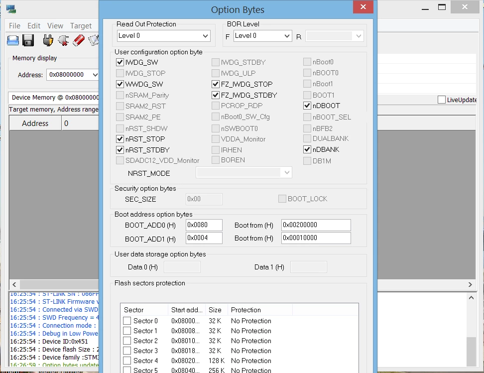

Case 2:
BOOT Pin = High;
BOOT_ADD1 = 0x0004 (Boot from 0x 00010000) (set via ST-LINK Utility)
In this case, the MCU go into the boot mode. I can flash the MCU via UART using the 'Flash Loader Demonstrator' but after RESET the MCU doesn’t start the USER code (LED not blinking). The MCU stays hanging in the Boot mode.
