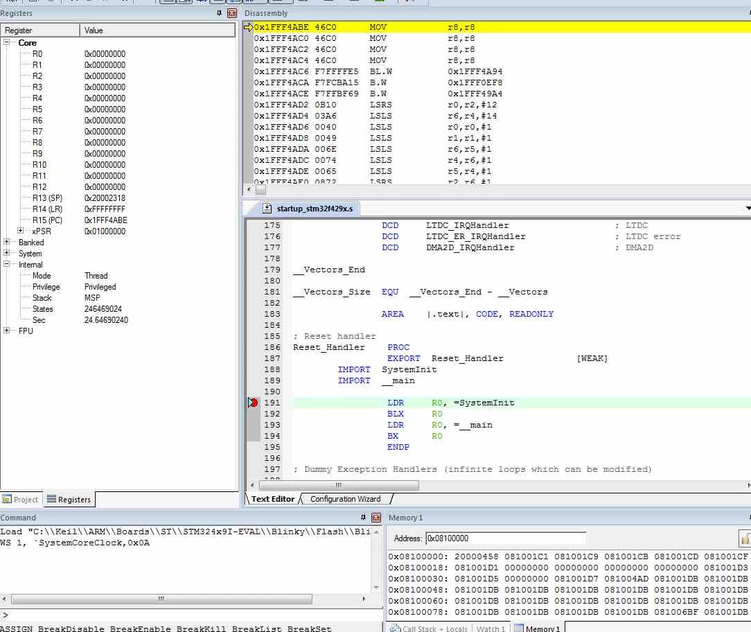

I run a program fine on bank 1. Then programmed BFB2 to 1. (BOOT0 = 0).
Compile Blinky to 0x08100000 and load it. Checked the flash by stlink-util and see
0000: 20000468 081001c1.
Those are correspondent to the .map file of STACK and reset_handler. Ok, good to go.
Of course it won't work.
I fired up the Keil debugger. found it began at 0x1fff 4abe, it's the bootloader. Fine, which is consistent to document. When BFB2 is 1, it will go to boot loader, then jump to bank 2.
content on memory windows that shows normal too.

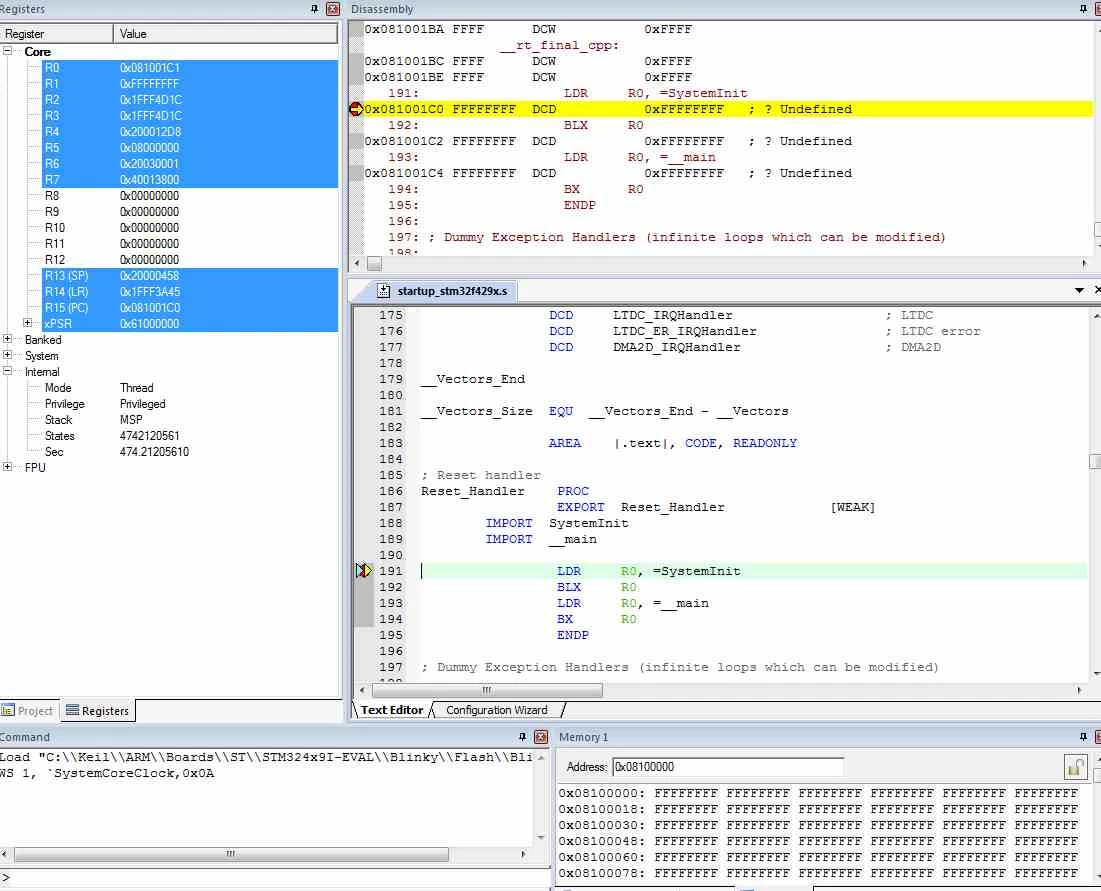

then after a few steps (0x1fff4ac6). PC become 0x081001c0. all the flash contect become FF. I checked again the content by stlink. It's still valid, not FF. and of course. The PC is not the address of reset_handler.
Somewhere in bootloader didn't go as I hope. (load SP from 0x08100000, and jump to 0x08100004 -> 0x081001c1 (reset_handle).).
I wonder what's go wrong....

    Review the memory subsequently mapped at ZERO and 0x08000000

    The hardware swaps Bank1 and Bank2 in the memory space, and can then map at zero.
    Change your memory view window to 0x08000000 in the debugger

    I am stuck now. It seems that in order to boot from bank2. I need to build/link the program at 0x08000000, but load it to 0x08100000. So later when bootloader make the address swap. it can run correctly. Is that right?
    When I tried to do that. I found neither Keil flash programmer nor STLink-util allow me to load hex file that build 0n 0x08000000 to 0x08100000.

    I'd supposed you'd compile/link for 0x08000000, and instead of using a .HEX, you get FromELF to make a .BIN file, which doesn't infer a load address, and then get the ST-LINK utilities to load the .BIN and program it at 0x08100000 from there (Start Address in Download dialog).
