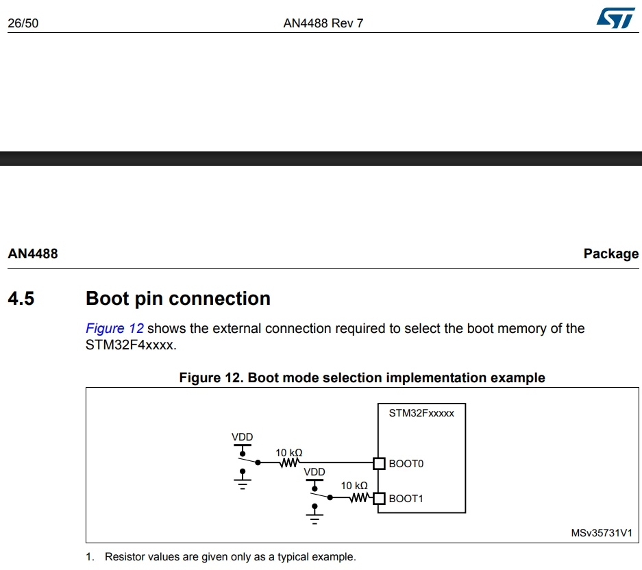

We are using STM32F469 and STM32F412 in our design.
Regarding the BOOT0 pin, we understand that a pull-down resistor is required to ensure boot from Flash. However, we could not find a clearly specified resistor value in the datasheet or application notes.
In many reference designs, a 10k ohm resistor is used. In some cases, lower values such as 510 ohm are used.
Could you please clarify the design criteria for selecting the BOOT0 pull-down resistor value?
Is there a recommended range?
What factors should be considered, for example noise or leakage current?
Why are lower values such as 510 ohm sometimes used?
We would like to have a clear technical justification for our design.

The examples in DS11139 (B.2, B.3) suggest 10k. This is obviously low enough to pull down reliably.
Any lower value increases the current without need, but will not hurt besides of that.

As  @mfgkw  said, the datasheet is the foundational document.
See also Application Note AN4488, Getting started with STM32F4xxxx MCU hardware development:

Hi Andrew,
Thank you for your response.
This is the EVK with the 510? resistor mounted as shown below.
The board name is STM32F469I-DISCO.

@Hitatachipoo415256  You can also connect the BOOT0 pin directly to GND, but that would no longer allow the pin to be explicitly set to 1. If you use 510?, then when setting it to 1 a correspondingly large current would flow, which is probably undesirable and is probably what @mfgkw  meant.
Since it is a CMOS input, practically no current flows out of or into BOOT0, so, as also mentioned just now, around 10k? is a common value, which also helps to attenuate any small interference picked up (BOOT0 is only queried during a very short time window at power-up anyway).

Using a low value resistor will not increase current draw as the pin is floating. Any value between 0 and 1meg or more will work.
