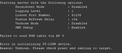

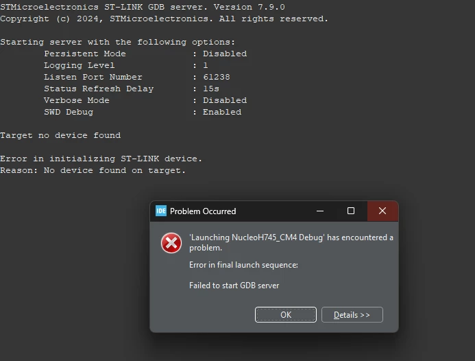

M7 gets debugged and runs. Once I start with M4 I get error messages and it bricks the controller.
I have been pulling up the BOOT0 pin and performing mass erase and trying things again, still it gets bricked when I try to debug CM4.

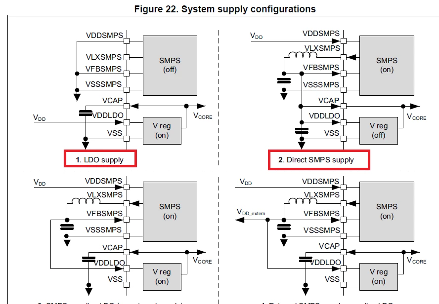

Also you said: "The board is designed with Nucleo-H745ZI-Q schematics"
Nucleo-H745ZI-Q board is using SMPS and not LDO configuration. Could you confirm you are not using SMPS in the HW?
If you used SMPS, that's normal and you've broken the board. In that case you need to recover it. Read this article.
Nov 28, 2024 8:19 AM UTC

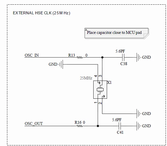

We are using LDO mode and I can confirm that. I have attached our schematics for reference.
We have missed pull down resistor on boot0 but I have added it externally on the hardware, Similarly I have also added a pull up resistor for PDR_ON pin.

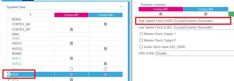

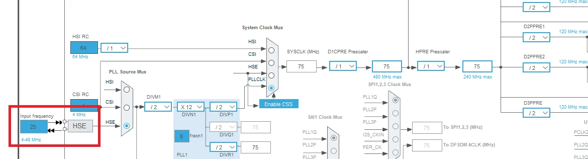

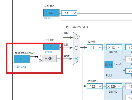

There is a mismatch between your RCC config i.e. you set an external 8MHz source in Bypass mode:
While in your schematics you have an external clock with 25Mhz / Crystal/Resonator mode:
You need to align the RCC config to fit your HW:
Attached the updated ioc file.

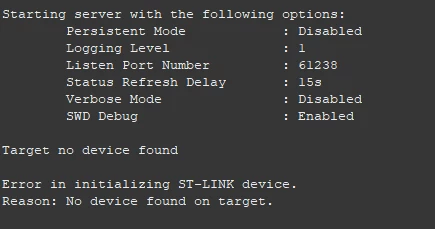

Nov 28, 2024 12:17 PM UTC
Hello SofLit,
Thank you, CM7 boots up and blink sketch works on the board.
But CM4 remains the same. It doesn't get detected at all. Any idea why?
mƎALLEm
mƎALLEmBest answer
Nov 28, 2024 1:02 PM UTC
Please comment these two lines in the main of CM4:
 HAL_PWREx_ClearPendingEvent();
 HAL_PWREx_EnterSTOPMode(PWR_MAINREGULATOR_ON, PWR_STOPENTRY_WFE, PWR_D2_DOMAIN);
These lines make the CM4 to enter in low power mode while debugging.
For debug, I suggest you to comment these lines but you can keep them while in standalone.
