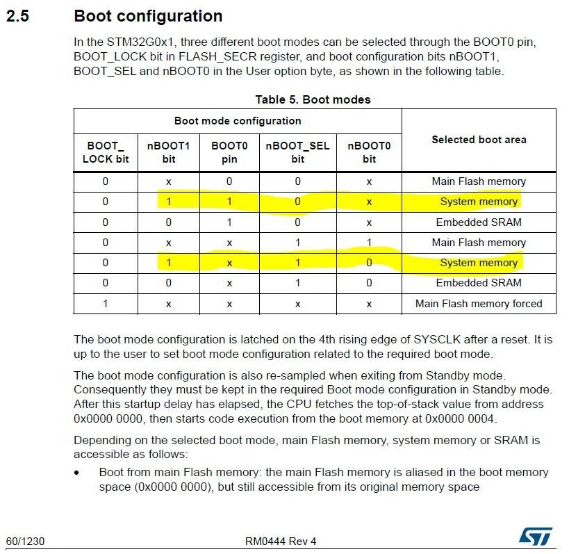

  1. In Ref manual on Pg 60 section 2.5 it is mentioned that for selecting boot from system memory we’ve 2 options.

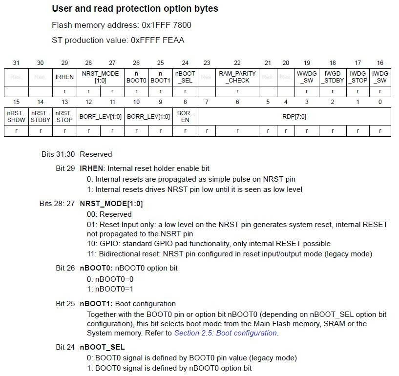

  2. Option Byte from Ref Manual, pg no 73 section 3.4.1 says that all nBOOT0, nBOOT1, nBOOT_SEL bits are 1
  3. so any of the option to select system memory boot will not work unless I change the option byte value in user application or using tools like STCubeProgrammer or DFuseDemo

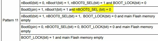

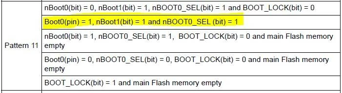

  4. In Application note(AN2606), on pg no 206 section 40.1 it is mentioned to refer pattern 11 from table 2 for STM32G07 controllers.
  5. Pattern 11 from table 2 pg no 24 section 4.1, 2nd option does not check nBOOT0 bit in option byte. So this option does not require any change in option byte as rest fields nBoot1 and nBOOT0_SEL bits are already set to 1 as in default value.

Thanks for taking prompt action, so with these options one cannot enter into system memory without modifying option bytes.
as default values in option byte does not fit into any of the above config combinations
I wanted to just control BOOT pin to enter into system memory and leave option bytes as default setting. please let me know if I can still achieve it some other way.

The pattern is built depending on the boot table of the STM32. You can check on the Table 8. Boot modes (page 66) on the RM0444: It seems the scenario needed is not possible.
