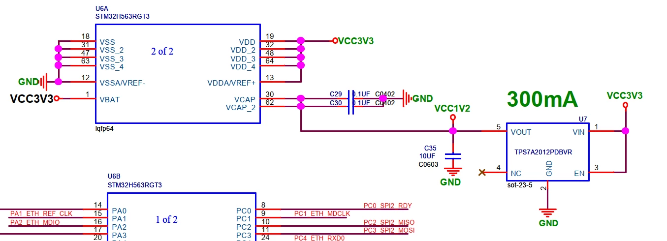

Board temperature limit test results
Hello Gyessine,
We tested the board in chamber, it seems that it can only work @105℃, even we decrease the CPU clock to 40MHz, if CPU clock is 200MHz, it only can work @95℃.
We are using seperate LDO for 1.2V Core, you can check the circuit below.

    Hello ​@lyan.2
    Sorry for the delayed reply
    what VOS are you using (0,1,2,3)?
