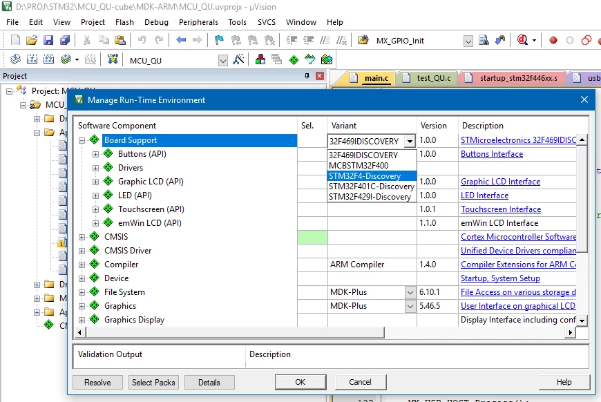

    Pavel A.
    Sep 27, 2018 12:48 PM UTC
    @OP Since you have a ST eval board and Keil, the Keil's DFP should have something that they call "Board support" for that board:
    This is all they have to offer. Basically they take this from demo software provided by ST,
    but present in nice form with components and checkboxes.
    If you have the original ST demo software, you can use that with Keil or any other IDE.

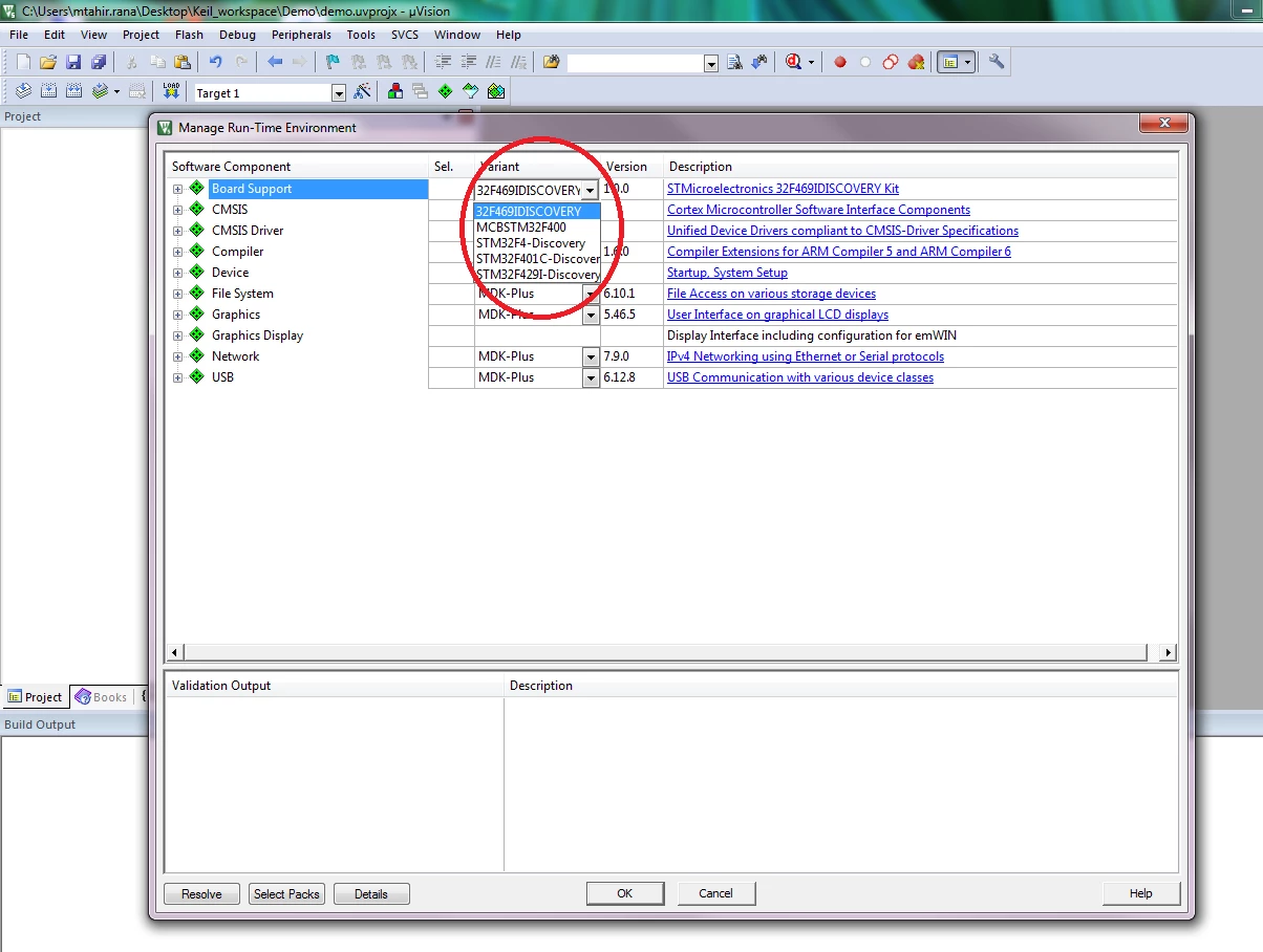

    MRana
    MRanaAuthor
    Sep 28, 2018 7:15 AM UTC
    @Pavel A.​
    Here is the photo, while I was staring the project. Although I could select the chip in the previous step, but I was not able to locate the board I am working with. That's why I was talking about *.bsp files. May be I am wrong. How will we be adding board support in our project, or we dont need that at all? Please see the picture below:
    AvaTar
    Senior III
    Sep 28, 2018 8:01 AM UTC
    The STM3240G is an older eval board, the docs state 2011 as initial release.
    You might check with the current Keil version if it is still supported (with DFPs). Perhaps at their forum.
    MRana
    MRanaAuthor
    Sep 28, 2018 8:47 AM UTC
    @Community member​
    Yes sir, DFPs for the chip are supported, but the board is not supported( so far :) )
