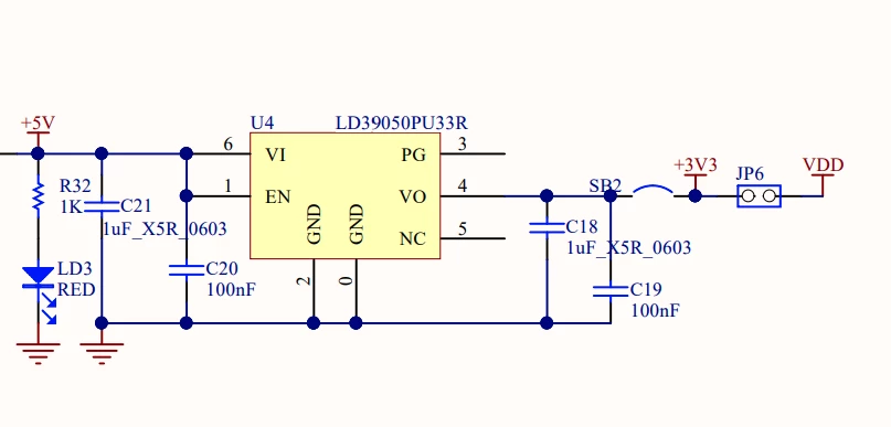

Question 1
Given Run Mode
~375uA Board incl MCU - ~210uA MCU —> ~165uA board
UART2 is configured but not in action
Given Standby Mode
~162uA Board incl MCU - ~2uA MCU —> ~160uA board
Where is the ~160uA going on the board
