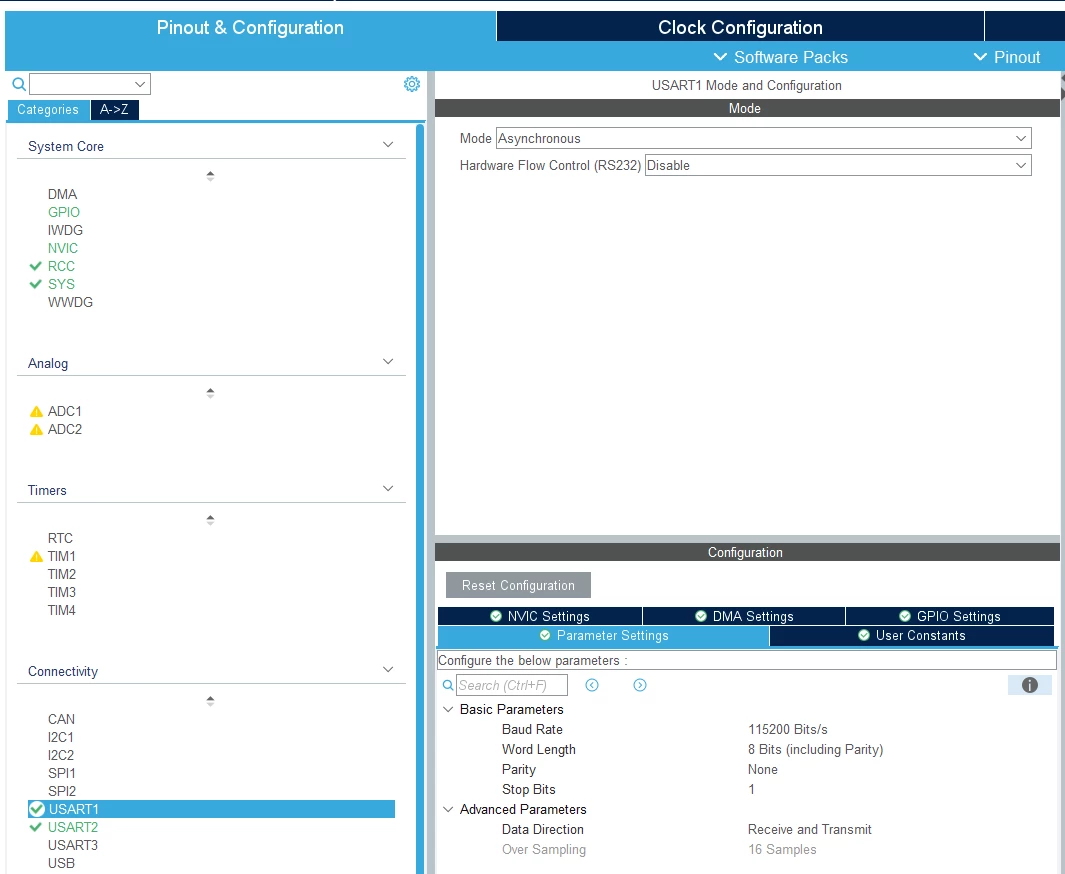

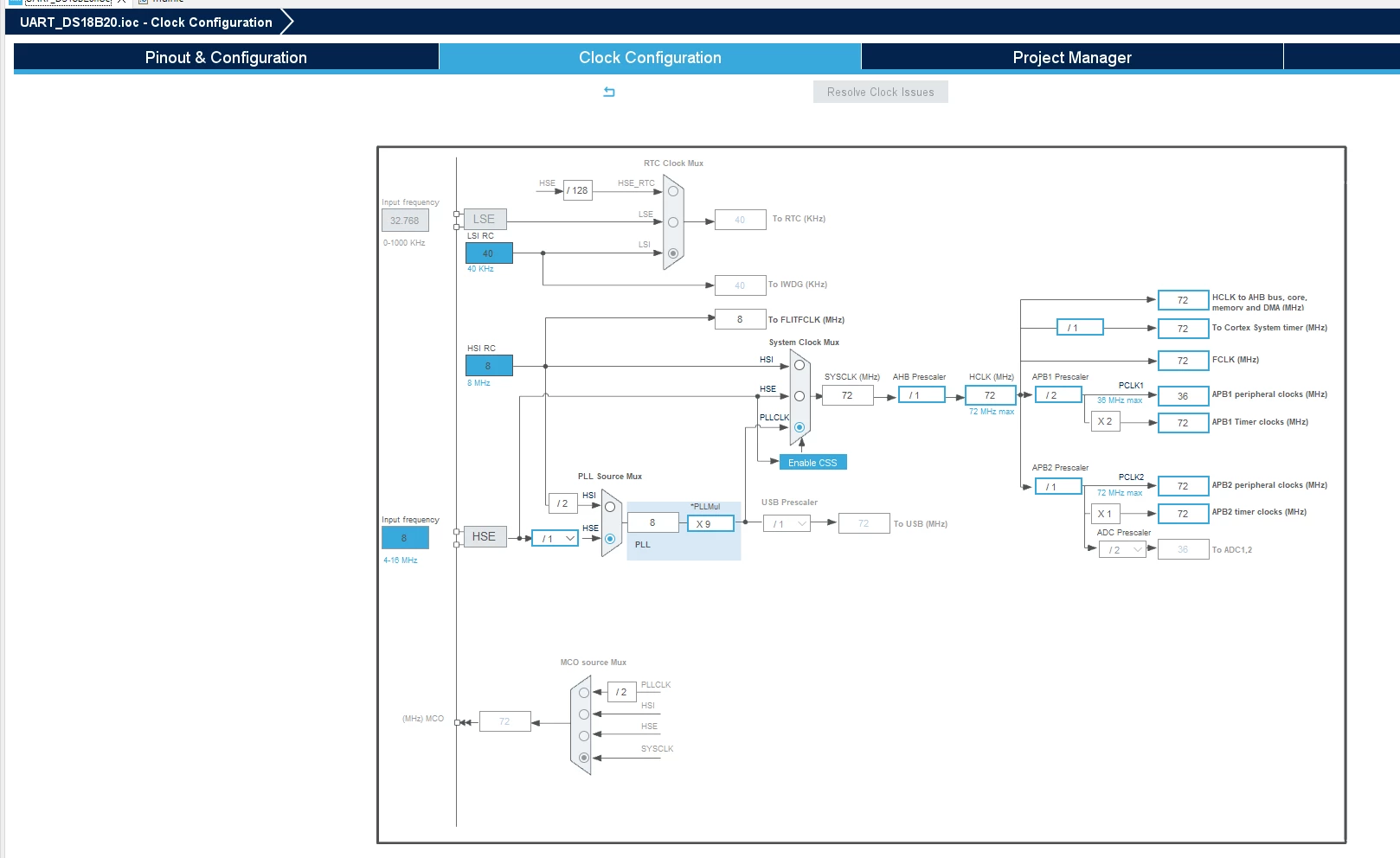

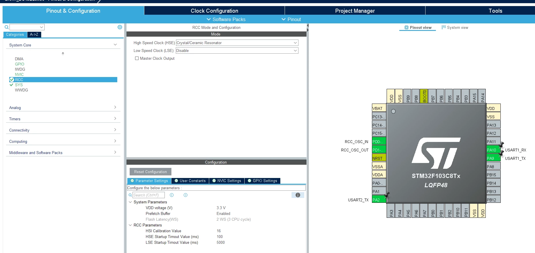

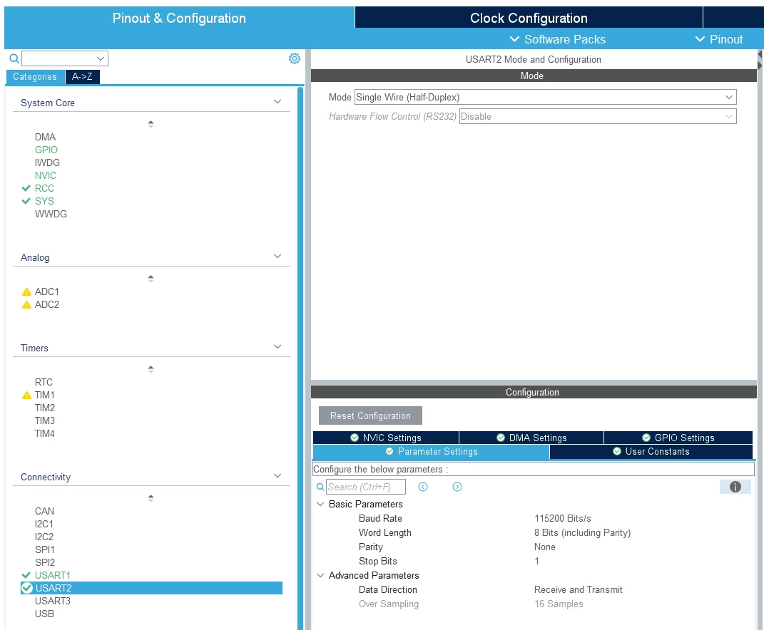

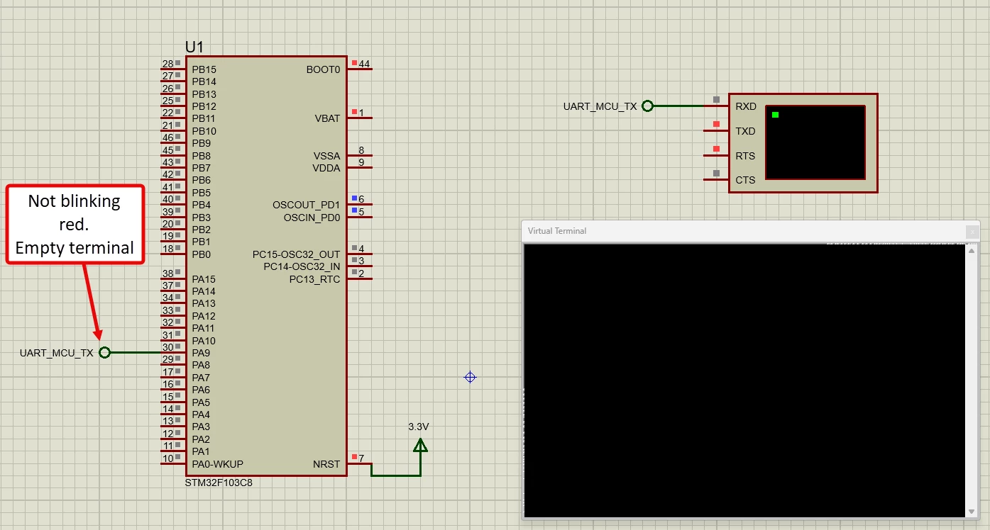

Hello, I am trying to wire STM32F103C8T6 with DS18B20 sensor and I realize that after some actions it stopped to work and no data through the UART sent:
Probably it's not big deal, but I have no idea why UART completelly blocked and sending no information.

You'll have to debug it. Your output buffer isn't really big enough to hold the string and NUL termination.
Try something more like
int number = 123;
uint8_t numarray[8]; // make sure you have enough space
while(1)
{ // sprintf returns the string length
 HAL_UART_Transmit(&huart1, numarray, sprintf(numarray, "%d\n", number), 1000);
February 28, 2025
I extended buffer size but unfortunately nothing changed...
Can be something wrong with configuration I applied?

Proteus has a debugger which allows you to step through the code - doesn't it?
So have you done that?
It also has "virtual" instruments (akin to oscilloscopes, etc) to observe signals external to the MCU.
Have you used them?
Have you got the UART working without the DS18B20 sensor?
