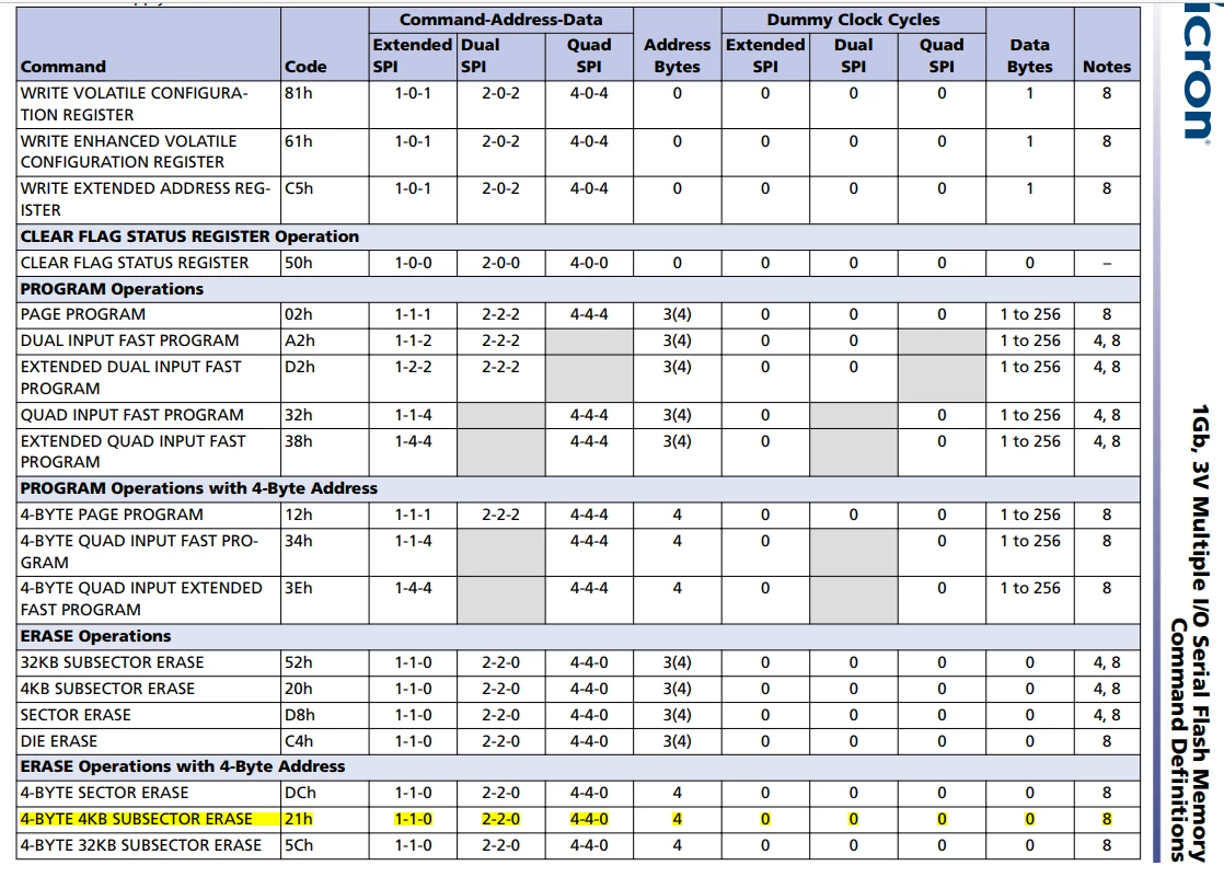

I am currently working on interfacing the MT25QL01GBBB NOR Flash memory with an STM32 MCU using the STM HAL QSPI library. While most operations such as read, write, and basic commands work successfully, I am encountering an issue with the block erase function.
The block erase operation does not seem to function as expected. After executing the block erase command, the memory contents remain unchanged. Additionally, modifying the dummy cycles in the erase function impacts the communication stability with the NOR flash chip. Specifically:
  • Dummy cycle = 1: Erase function is sent, but the memory is not cleared.
  • Dummy cycle = 0: Communication with the chip fails, resulting in status register and other commands returning incorrect values.
Despite following the MT25QL01GBBB datasheet closely, the block erase functionality is not performing as intended. Below are the details of my setup and the code being used.

Questions for the Community:
  1. Dummy Cycles: Could there be an issue with the number of dummy cycles specified in the HAL library or the command configuration?
  2. Addressing Mode: Is there a possibility that the 3-byte addressing mode is causing this issue with the block erase command?
  3. Driver Compatibility: Are there known limitations or adjustments required for the STM32 HAL QSPI library to support the MT25QL01GBBB erase functionality?
  4. Erase Procedure: Are there any additional steps required (e.g., specific configurations for MT25QL01GBBB) before or after executing the erase command?
Any insights, recommendations, or solutions from the community would be highly appreciated!

Hello @Mohammed Eshaq,
Which STM32H7 are you using?
The dummy cycle must be configured depending on the memory datasheet.
As mentioned in the memory datasheet, for erase operation, the dummy cycle is equal to 0.
Are you using 4-BYTE 4KB SUBSECTOR ERASE 0x21 operation?
Before 0x21 operation, the WRITE ENABLE command must be issued first. Also, 0x21 operation support only 4 address bytes as mentioned in the above table.
I recommend you to refer to QSPI_MemoryMappedDual example and check your configuration and settings. This example describes how to erase part of the QSPI memory, write data in IT mode and access to QSPI memory in memory-mapped dual mode. This example has been tested with STM32H747I-EVALUATION BOARD and MT25TL01G memory.
Did you find an issue when using 4KB SUBSECTOR ERASE 0x20 operation?
I hope this help you!
Thank you.
Kaouthar

You did realize that the flash device is a two-stacked die device, didn't you? I've always resisted to use these devices as the handling is prone to cause difficulties: the handling of inter-die communication varies across manufacturers and is sometimes not clearly documented. So, are you sure you can already write and read the *entire* memory? I.e. full 128MBytes of random data? In particular, status register must be read twice to retrieve both status registers (of both dies).
Tesla DeLorean
Guru
December 18, 2024
A 128MB device is going to need to be in 4-byte (32-bit) addressing mode. The 3-byte (24-bit) is only good to 16MB/128Mb
Two die mode requires you loop reading the Flag Status Register twice, and BOTH must flag ready. You can't use AutoPolling of the Status Register on one die.
Erasing can fail/complete immediately if the BP (block protection) bits are set in the Status Register, there's also a failure flag in the Flag Status Register.
There isn't a Mass Erase, you must erase each die, selected via the address
Used the 01G, 02G and 04G parts on STM32's, work fine.
Dummy Cycles, memory and STM32 need a consistent view of this, the memory will expect you to respect the setting it had internally.
