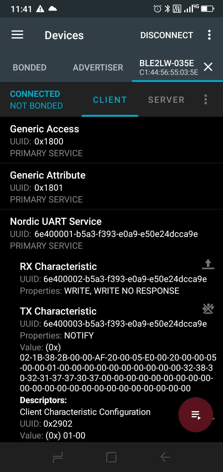

This screen shows the notification received by Nordic MCU-based devices (complete).

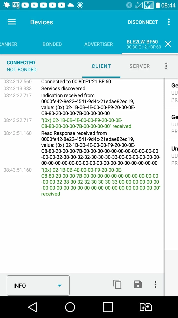

This screen shows the Nordic app log. At 08:43:22 the notification was recorded (20 bytes). At 08:43:51 the message is recorded after clicking the down arrow (read with 62 bytes).

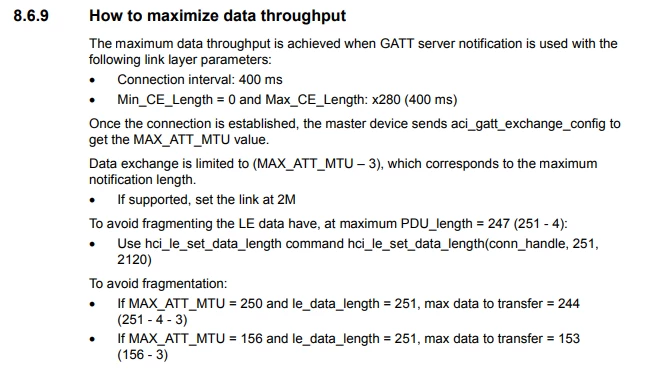

Is there a way to change the size of the notification (let's see, the notification, not the payload itself) or is it a feature of the BLE-SIG stack implementation to transmit notifications up to 20 bytes?
I advise you to have a look at the AN5289, on how to maximize data throughput.
Imen

I followed the paths in the document that they indicated to me and the problem was resolved. We are still in preliminary tests, but the fact is that so far everything is wonderful! I can't describe how important your help is!
