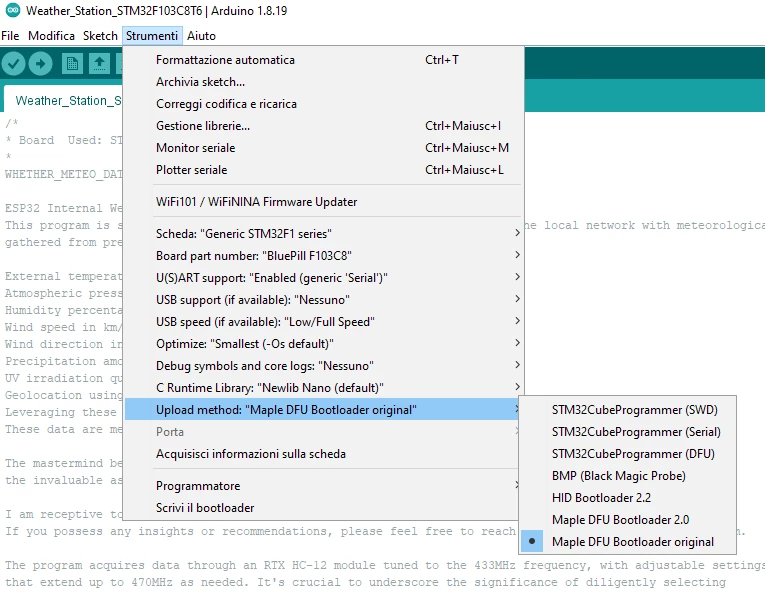

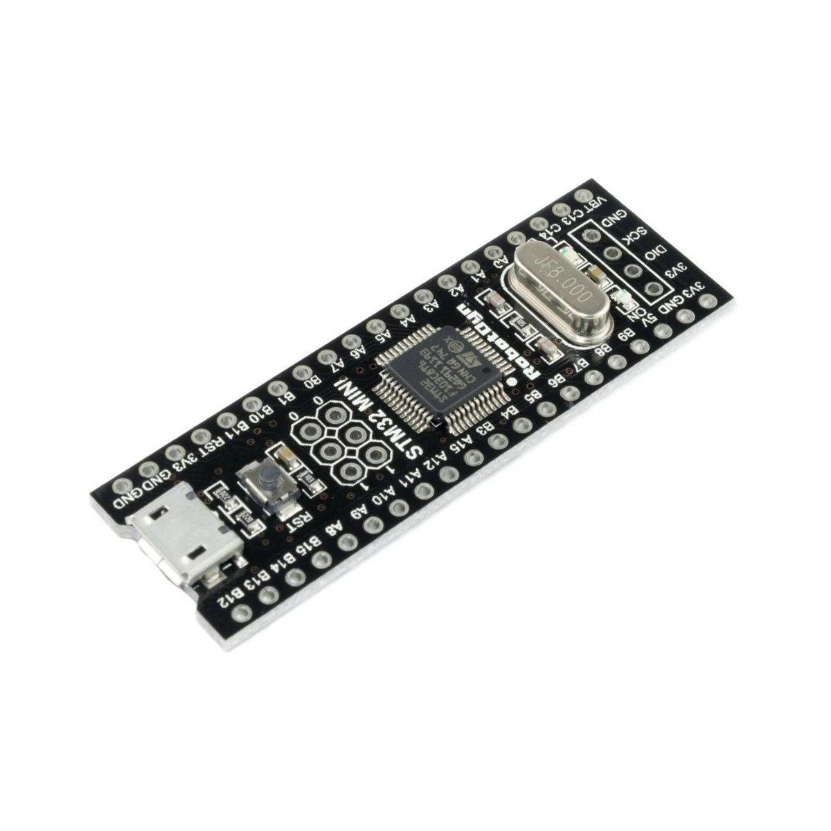

Hi, I'm trying to figure out how to program this MPU with the Arduino IDE.
I tried to make the serial port appear but without any success.
Unfortunately I have lost all reference to the purchase and it seems that RobotDyn no longer exists.
I tried the following configurations:
BlackPill F103C8
BluePill F103C8
BluePill F103C6
I tried to install the bootloader with STMCubeProgrammer using the following bootloaders:
generic_boot20_pc13, generic_boot20_pc13_fastboot, maple_mini_boot20
I installed the following USB drivers:
install_drivers.bat
install_STM_COM_drivers.bat
wdi-simple.exe
In all possible permutations, but I was able to program this board.
And STLINK isn't even displayed, at most I see a Maple_003 port which I tried to use but without success.
Where am I doing wrong ?

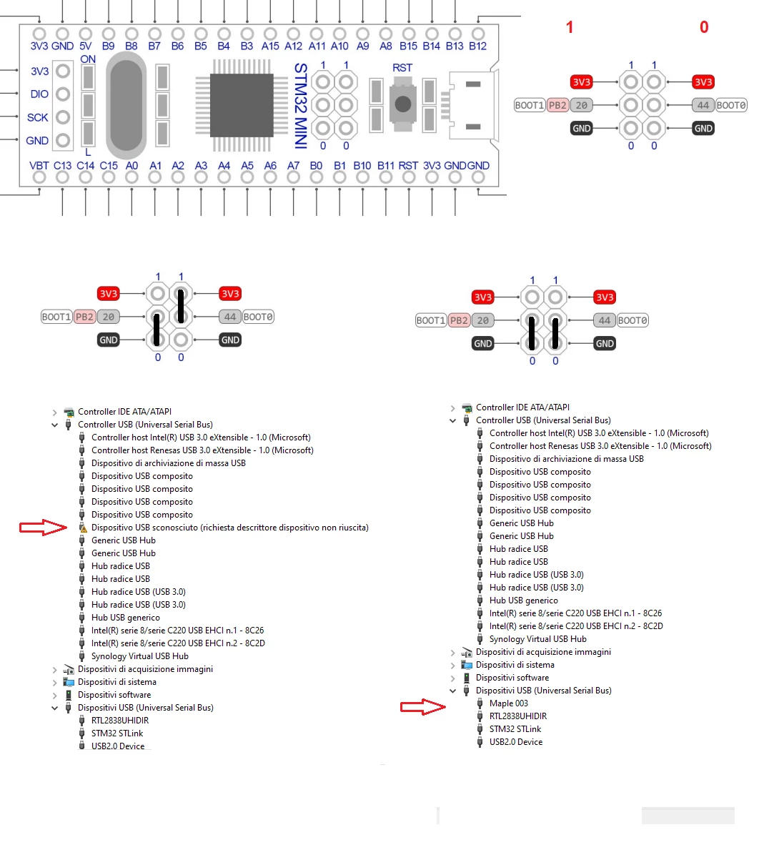

You don't have an ST-LINK, you aren't going to see one.
To access via USB and STM32 Cube Programmer, you need to set the BOOTx jumper pins so that the STM32F1 starts in System Loader mode.
BOOT0=HIGH, BOOT1=LOW
https://community.st.com/t5/stm32-mcus-embedded-software/boot0-boot1-pins-boot-mode-doubt/td-p/472463
The board should then present via USB as "STM32 BOOT DEVICE" or something similar, and you connect in STM32 Cube Programmer using the USB/DFU option, and not as ST-LINK

yes, that's what I did but the USB Serial port doesn't appear

Oct 16, 2023 8:13 PM UTC
I also changed the jumper during bootloader programming, but in any case I don't see the serial port but only Maple 003

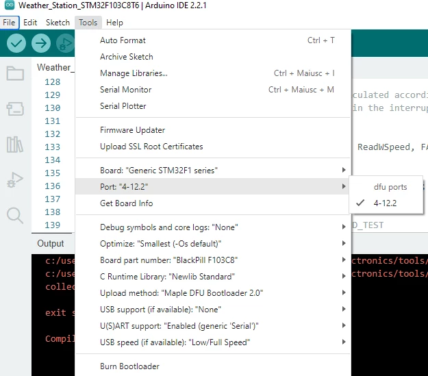

SuntchiAuthor
Oct 17, 2023 6:43 AM UTC
Many thanks everyone for your suggestions.
So, this is the situation after trying to install both the maple_mini_boot20 and generic_boot20_pc13 bootloaders, both with the BOOT0 jumper set to 1
I have never programmed a board with the STM32CubeProgrammer, I only saw online how to install the bootloader.
In the condition where the Maple 003 port is displayed on the Arduino IDE, the dfu 4-12.2 port appears but even using that I cannot program the board.
Is it possible to program it using the STM32CubeProgrammer?
Is there a guide to do this?
