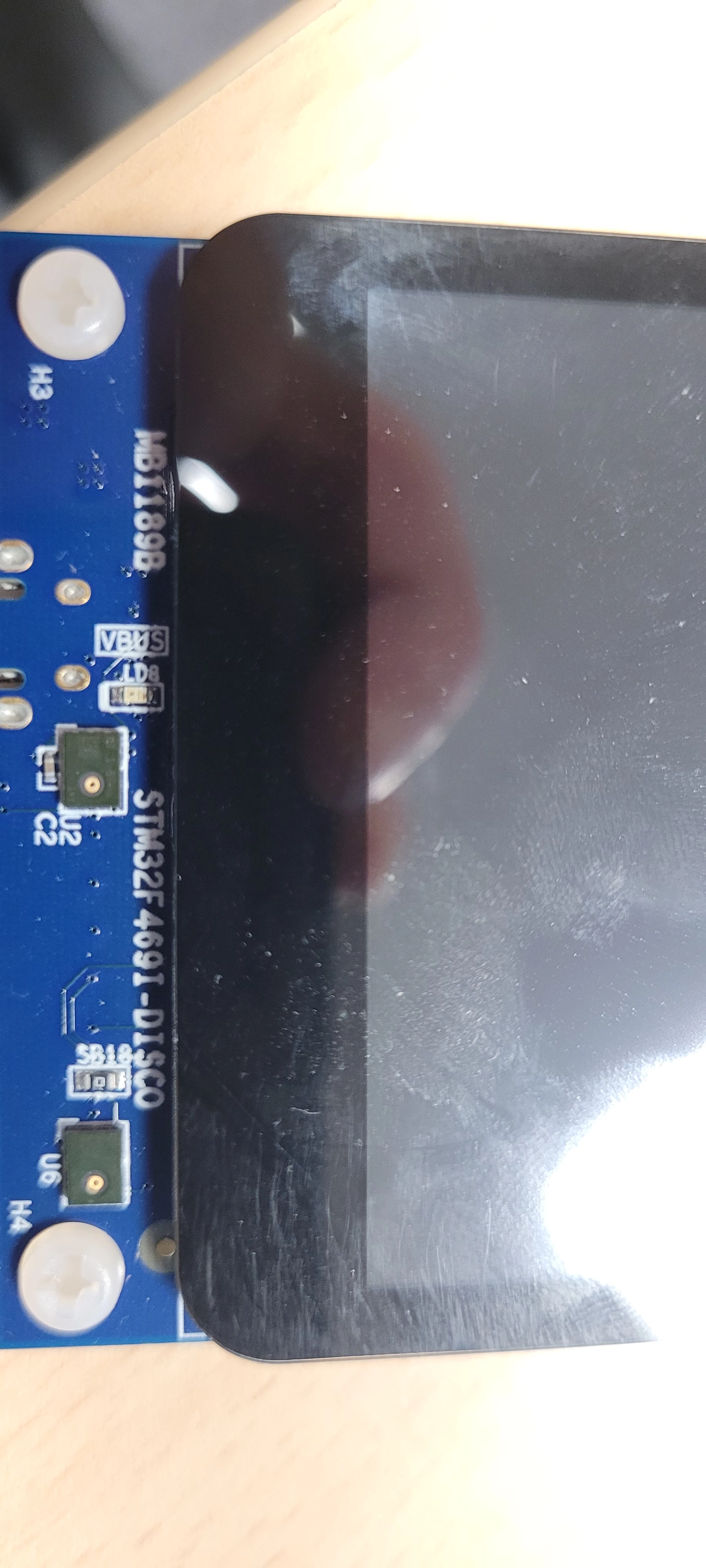

The project compiles without errors. But when I flash the board the screen stays black.
Then I tried to revert erverything regarding UART and Debug Serial Wire (deactivate USART3, disable Debug) but the screen stays black.

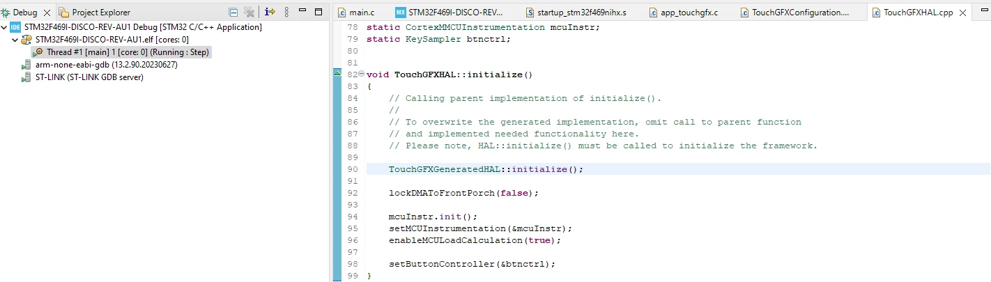

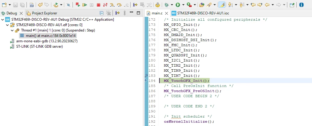

Right now, the MX_TouchGFX_Init(); does not finish. See screenshot.
EDIT:
We seem to stop here:

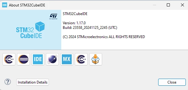

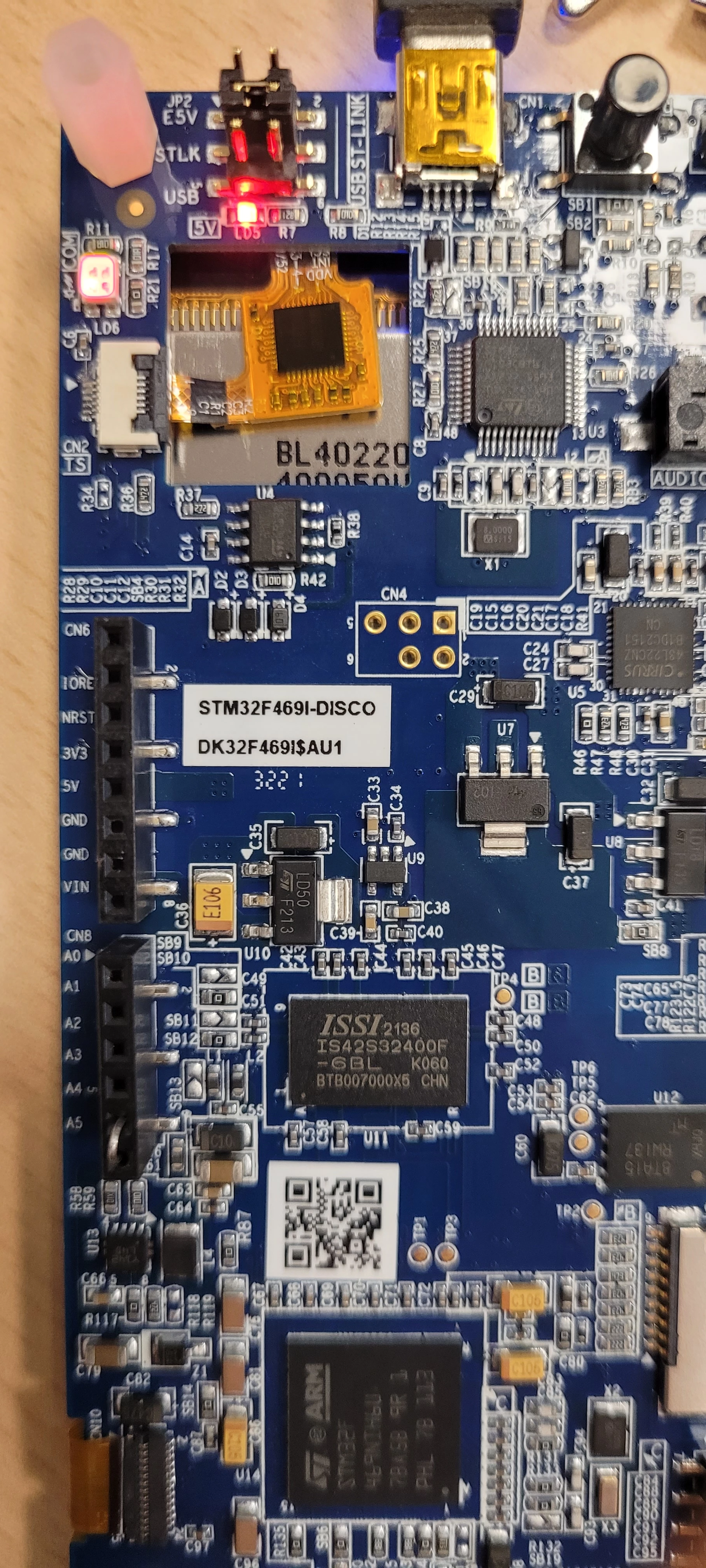

Could you share the STM32F469I-DISCO board revision and the software versions STM32CubeIDE, TouchGFX? Are you using the latest software versions?

Hello @KDJEM.1,
CubeIDE Version: 1.17.0
TouchGFX Version: 4.24.1
I always used this board in TouchGFX:
Disco Board Version:
Thanks,
