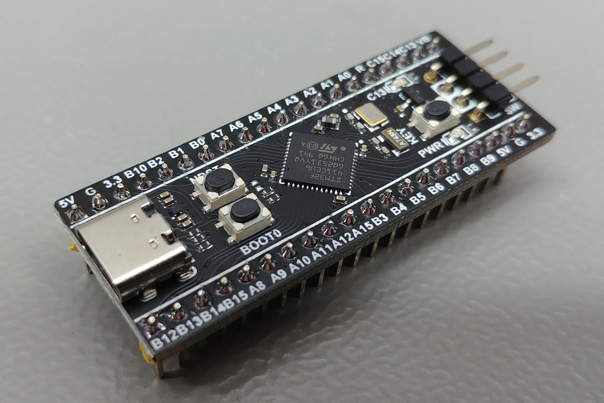

mƎALLEm
Sep 5, 2024 9:46 PM UTC
Hello @zeus  and welcome to the community.
@zeus wrote:
Hey guys!
I'm trying to run the eaxmple found in this link: https://deepbluembedded.com/stm32-serial-port-uart-with-usb-ttl-converter-pc-interfacing/
I don't think you can expect that someone will be going to look at this link and read all of its content.
Better to summurize and provide what you did and share the exact code you written (not the one in the link).
Need also to check if you have a genuine ST MCU on board or it's fake ..

Also, The board I'm using currently is this:
So, When I run the above code. The corresponding GPIO is not responding. Kindly help. Thanks in advance!

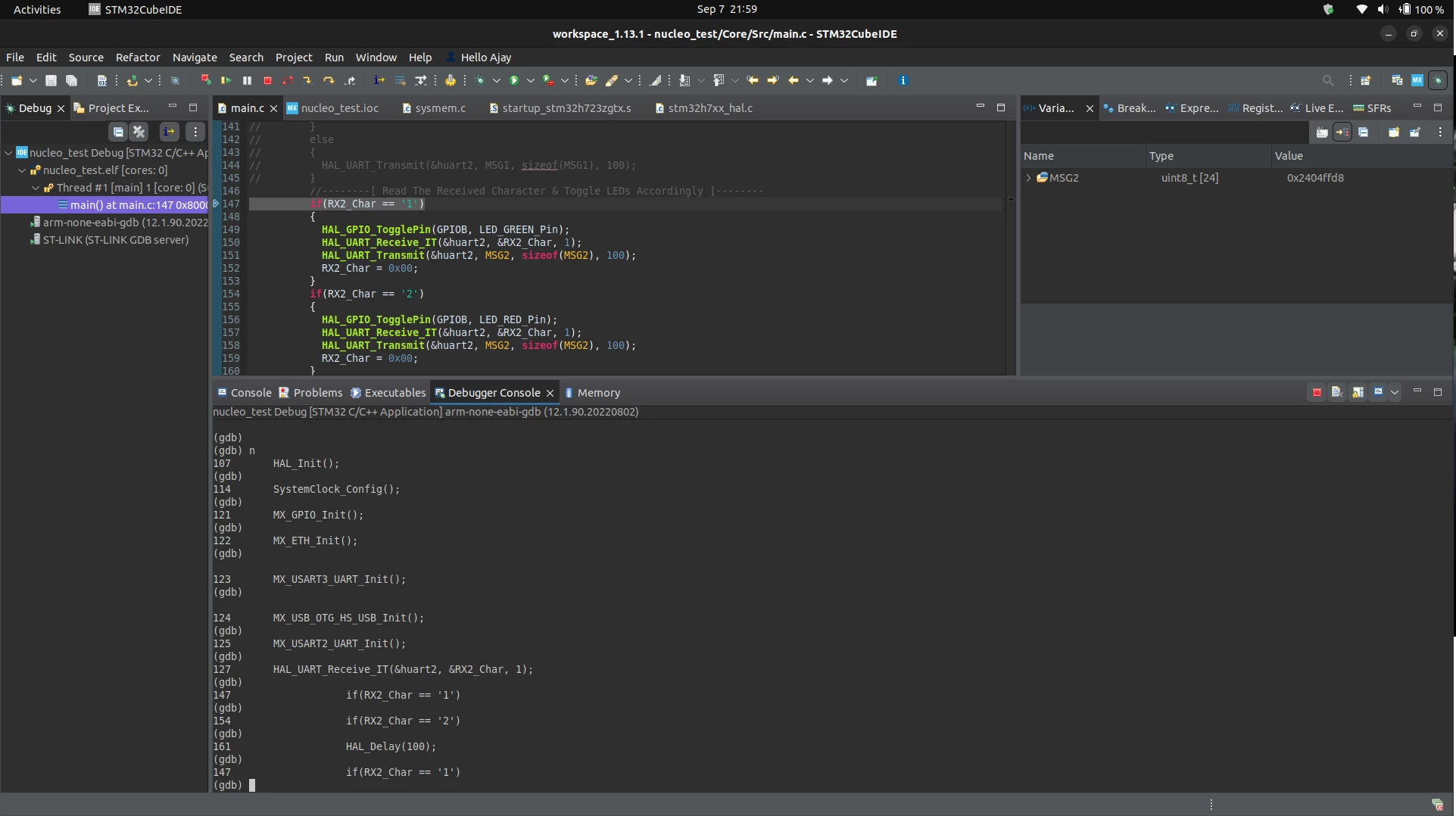

Okay, So I tried debugging the code with debugger. I'm able to see that the if statement is not satisifed. I'm new to STM32 and I'm not sure how to print the values on debugger console. Can anyone please help me with that? Also, check the image for reference:
Pavel A.
Sep 7, 2024 9:26 PM UTC
@zeus So are your questions now about Nucleo-H723ZG (with genuine ST-LINK on-board) or black pill?
zeusAuthor
Sep 8, 2024 3:32 AM UTC
Well, my question is how to make the uart code work as I'm not sure what am I missing. I'm using Nucleo-H723ZG (with genuine ST-LINK on-board) to debug the code as I don't have sepate debugger to test on black pill. So, how can I print the variables in the debugger console while using the st-link onboard?

mƎALLEm
mƎALLEmBest answer
Apr 14, 2025 2:48 PM UTC
ST resources are dedicated to supporting genuine ST products. We are not committed to ensuring that clones/fakes work properly with the firmware we provide.
Thank you for your understanding.
