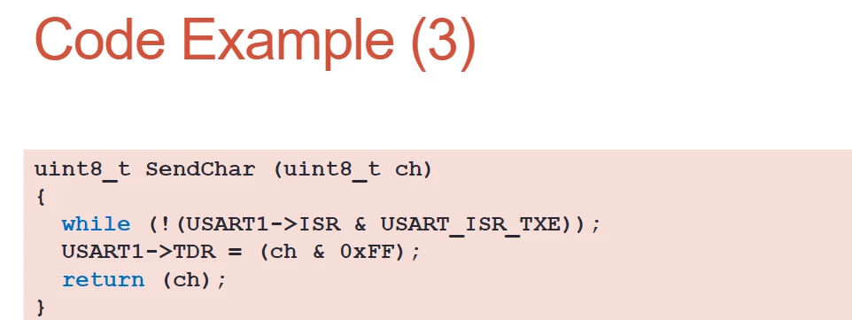

"I'll delete this question once someone answers it, as it is not relevant".
0693W00000QMqCCQA1.pngWhy in second line did some one write ch & 0xFF? ch limits are already 0 to 255 right?

    The copy-n-paste coder here took code that use int originally for the parameter/return and changed it to a uint8_t
    Classically C libraries have returned negative values for failure around STDIO routines.
    The TDR here is 16-bit wide as the U(S)ART support 9-bit values. When reading RDR and using parity, the code needs to strip the parity bit manually/

    Maybe because function content was copy pasted from elsewhere which ch may not have been uint8_t. Anyway, compiler are not dumb, they will optimise this, no sweat.

    You're right. The &0xFF is useless here.
