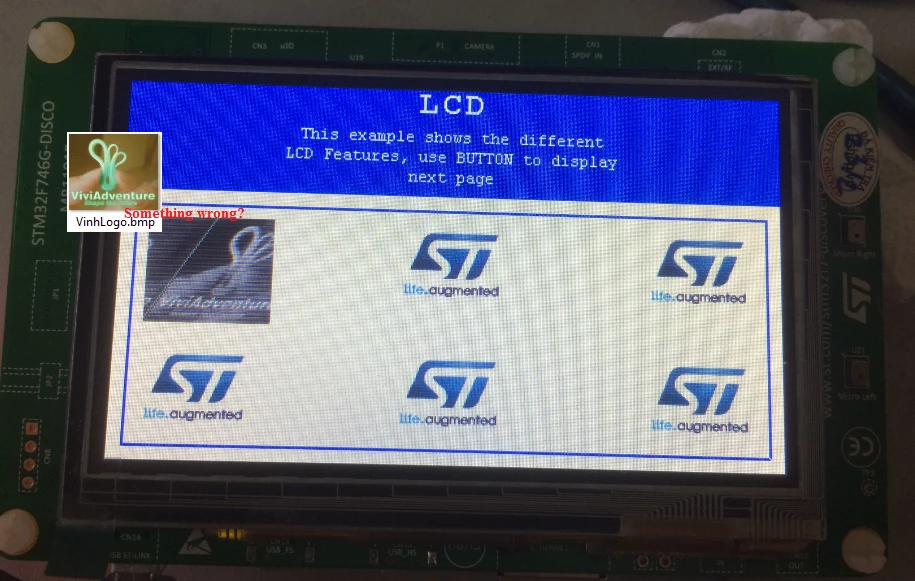

Hi all
Recently, I created a Win32 application to convert a bitmap (.bmp) file into a header file (.h) in order to display it in mySTM32F746G-DISCO discovery board. Everything works fine but the bitmap (24 bit depth) displays differently (see attached photo) compared to the original bitmap.
Does everyone experience the same? The displayed bitmap seems to be skewed and de-colored. I have done again with a 16-bit-depth bitmap but no further advance.
(I reused the BSP example in STM32CubeF7Packets for the test)

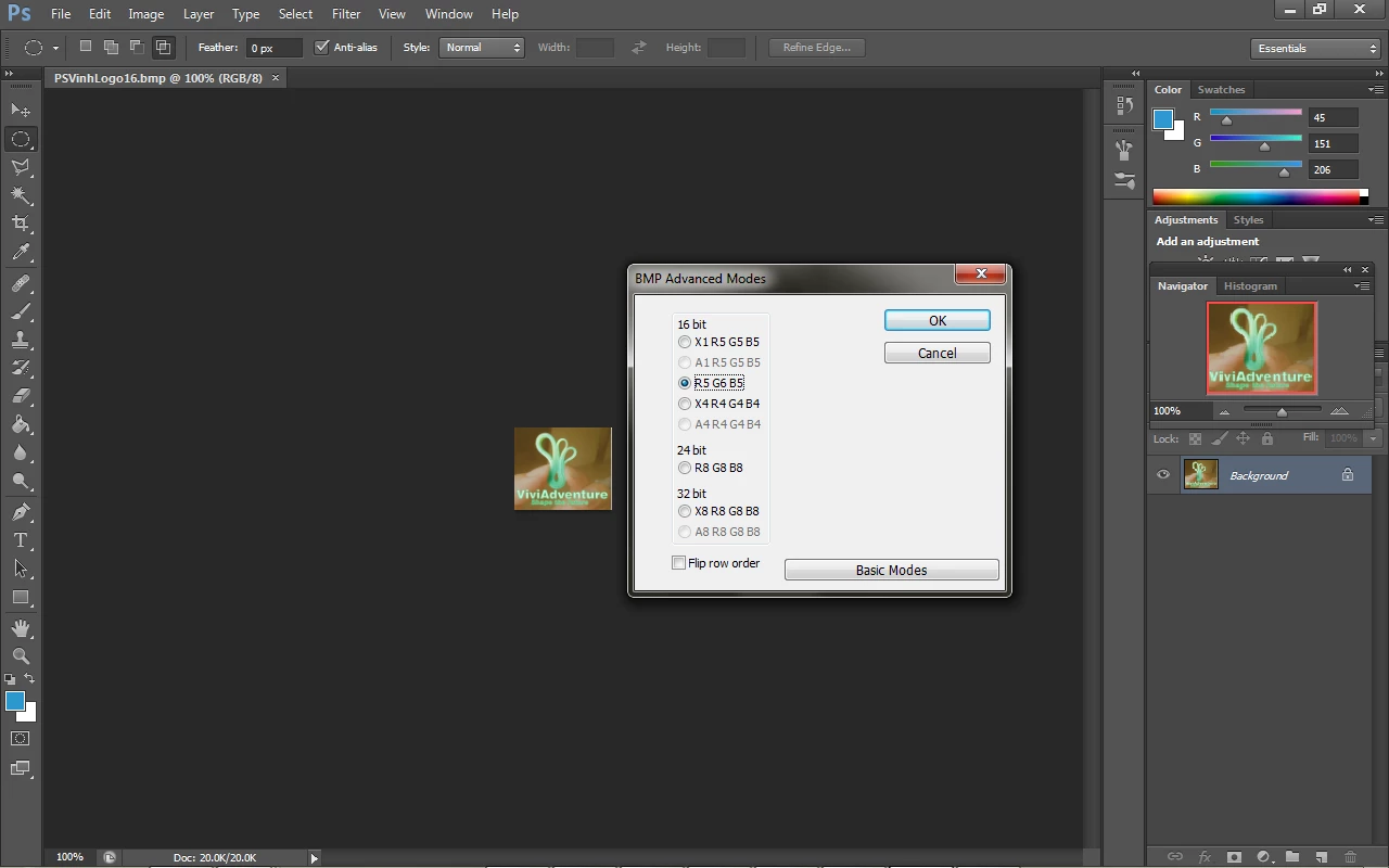

    Yeah! Finally I have resolved the problem:
    The problem is that there are many formats for a .bmp file. The original bitmap is of 24 bit depth so the LCD driver handled it poor. I changed it to 16 bit, it displayed well (no skew anymore) but with just a few color. I used Photoshop to change it to RGB565 and it is OK.
    Thank you all for kindly help and suggestion.

    Thanks for your reply.
    I converted the entire .bmp file where the header contains all information about the index, width, height and bit-depth. I also found that the LCD driver has mechanism to check it. Something likes below:
    /**   * @brief  Draws a bitmap picture loaded in the internal Flash in ARGB888 format (32 bits per pixel).   * @param  Xpos: Bmp X position in the LCD   * @param  Ypos: Bmp Y position in the LCD   * @param  pbmp: Pointer to Bmp picture address in the internal Flash   * @retval None   */ void BSP_LCD_DrawBitmap(uint32_t Xpos, uint32_t Ypos, uint8_t *pbmp) {   uint32_t index = 0, width = 0, height = 0, bit_pixel = 0;   uint32_t address;   uint32_t input_color_mode = 0;      /* Get bitmap data address offset */   index = *(__IO uint16_t *) (pbmp + 10);   index |= (*(__IO uint16_t *) (pbmp + 12)) << 16;      /* Read bitmap width */   width = *(uint16_t *) (pbmp + 18);   width |= (*(uint16_t *) (pbmp + 20)) << 16;      /* Read bitmap height */   height = *(uint16_t *) (pbmp + 22);   height |= (*(uint16_t *) (pbmp + 24)) << 16;       /* Read bit/pixel */   bit_pixel = *(uint16_t *) (pbmp + 28);         /* Set the address */   //address = hLtdcHandler.LayerCfg[ActiveLayer].FBStartAdress + (((BSP_LCD_GetXSize()*Ypos) + Xpos)*(4));   address = hLtdcHandler.LayerCfg[ActiveLayer].FBStartAdress + (((BSP_LCD_GetXSize()*Ypos) + Xpos)*(4));      /* Get the layer pixel format */       if ((bit_pixel/8) == 4)   {     input_color_mode = CM_ARGB8888;   }   else if ((bit_pixel/8) == 2)   {     input_color_mode = CM_RGB565;      }   else    {     input_color_mode = CM_RGB888;   }      /* Bypass the bitmap header */   pbmp += (index + (width * (height - 1) * (bit_pixel/8)));        /* Convert picture to ARGB8888 pixel format */   for(index=0; index < height; index++)   {     /* Pixel format conversion */     LL_ConvertLineToARGB8888((uint32_t *)pbmp, (uint32_t *)address, width, input_color_mode);          /* Increment the source and destination buffers */     address+=  (BSP_LCD_GetXSize()*4);     pbmp -= width*(bit_pixel/8);   }  }

    As said, I neither have a F746 disco, nor do I use Cube code. I draw from experiences with other boards/LCD drivers and SPL library code.
    I also found that the LCD driver has mechanism to check it. Something likes below: ...
    Is this function aware of the current colour mode of the LCD driver ?
    This mode is usually set during initalization in some config register.
    LCD driver ICs I dealt with also supported BW, 8-bit, 16-bit and 18-bit modes.
    The image seen on your initial post seems to have bits end up in the wrong colour.

    Posted on April 20, 2017 at 11:27
    Could you please provide the Layer Settings of the LCD from CubeMX project?
    Probably, you have to re-configure the Pixel Format of the Foreground(Layer 0). I suggest to use RGB888 or ARGB888 format.
    In any case you may have to confirm that the pixels of the bitmap are 'aligned' in the peripheral's memory.
    For example, if you use
    RGB888 format (3 bytes per pixel) and the address of the Layer Buffer begins at 0xC0000000, your first pixel should occupy the memory addresses 0xC0000000,0xC0000001,0xC0000002, [R-G-B] the second 0xC0000003, 0xC0000004, 0xC0000005... etc.

    Posted on April 20, 2017 at 11:48
    Here is the layer setting:

    You can find the whole example project in the Cube downloaded from st website.
    By the way, the bitmap used is 90x76 in size. It means that the bmp file must be of 90*76*4+54=27414 bytes. However its real size is 20726 bytes. The bitmap was edited in Paint.exe in Win7. I don't know why it loss a thousand of bytes. Could anyone explain it more detail?

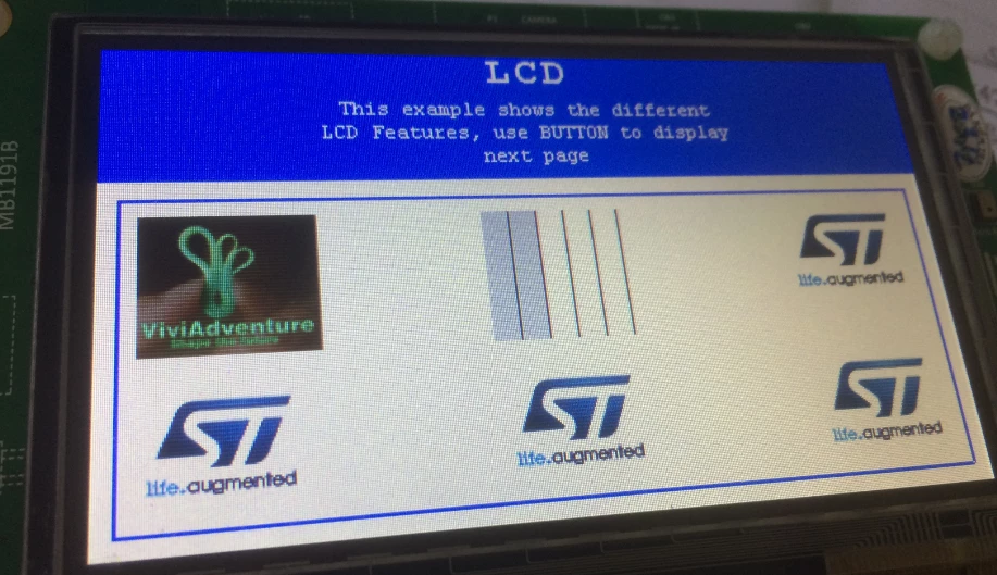

    Thank you so much for sharing this result. I had the exact same problem and could not find the solution anywhere.
    For anyone who may encounter the problem on the STM32L562E-DK (which mounts a st7789h2 240x240 TFT LCD):
    I solved by saving the BMP in the same format as showed in this post (R5 B6 G5) by using GIMP, loading it to a HEX converter (I've used HxD) and exporting it as a C file, which I've used as header in my project.

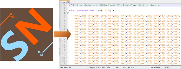

    Hello, i made an open source software to convert any picture (jpg, bmp, png) to a header file (.h) in one clic.
    you can download it here :
    http://www.electro-info.ovh/bitmap2headerfile
    The software is in french but it is not difficult to use it.
