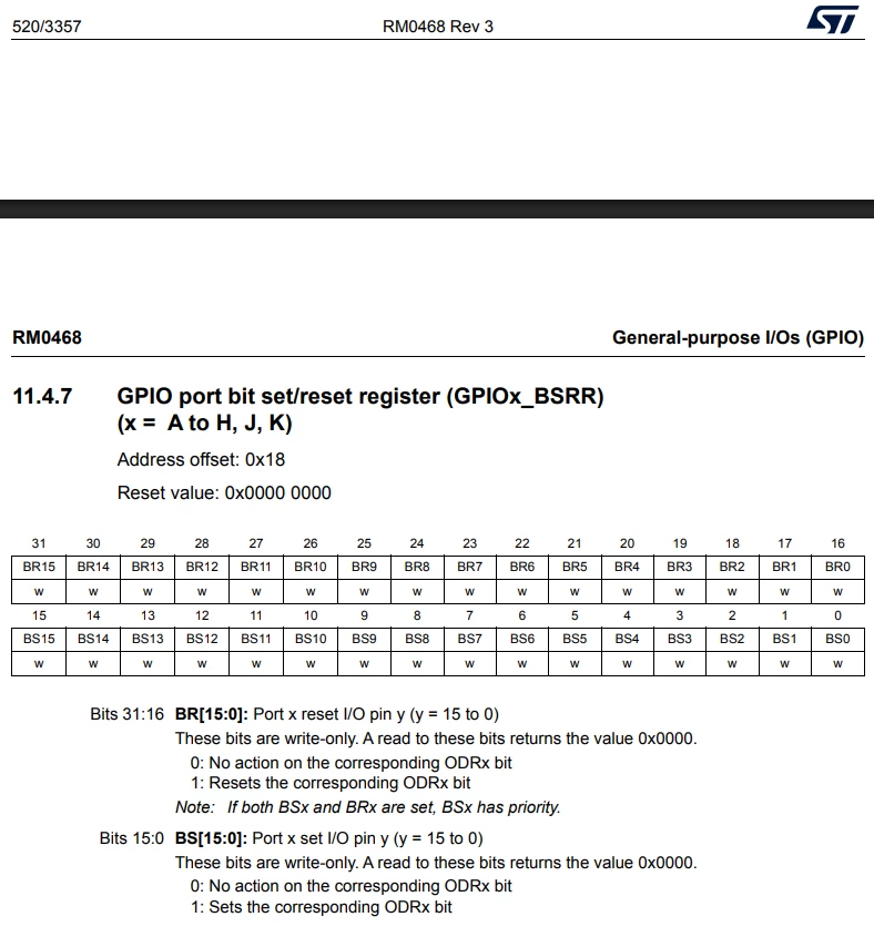

Andrew Neil
Nov 11, 2025 10:53 AM UTC
@Komal_Y wrote:
  • Available alternative methods for atomic bit manipulation
Check if your particular chip has a register (or registers) to give atomic bit manipulation; eg,
That's for STM32H723/733, STM32H725/735 and STM32H730:
https://www.st.com/resource/en/reference_manual/rm0468-stm32h723733-stm32h725735-and-stm32h730-value-line-advanced-armbased-32bit-mcus-stmicroelectronics.pdf#page=521
PS:
You'll probably find that HAL uses this - it certainly does for F0.
